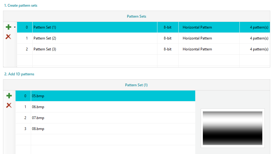

    Thank you for your reply. I have a series of sinusoidal fringe patterns to display (Please see the figure below). The pattern is 480 rows x 1 col in size (the EVM will copy the pattern to every column) and 8 bit.

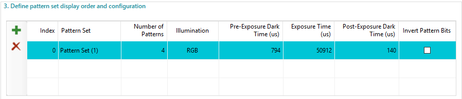

    I would like to display the pattern for some desired period of time and therefore, I look into adjustment of exposure time (in Fig. 2). For small exposure time like 1000 us, I can see the pattern perfectly if I click on Pause. But I want the pattern to stay there for longer period of time without clicking on the Pause button. When I increase the exposure time to like 50000 us, I will see the pattern flashing. The flashing includes two parts. One part is RGB color switching. The other part is the bit-plane switching. So I wonder if there is any way that I can keep the pattern stay still for any period of time without the flashing issue.

  • Hi Jeff Leung,
    Kindly look into the "Sequence Timings for DLPC347x Light Control Platform FAQ". It will provide you the info regarding the range of supported exposure timings.
    Unfortunately, the pattern exposure times which you are looking for are not supported.
    One simple solution which I can think of for your requirement is that you can display a single pattern multiple times in order to achieve a higher single pattern display time. But, please note that the pattern will not be displayed continuously as there will be pre and post exposure dark time associated with each run.
    Thanks and regards,
    Mayank
  • Hi Mayank,
    Thank you for your reply. I was thinking of the same way to achieve higher pattern display time too, meanwhile wondering if there is any other built in function that I haven't noticed. It seems that displaying the pattern repeatedly is the right way to extent the display time. Many thanks.
