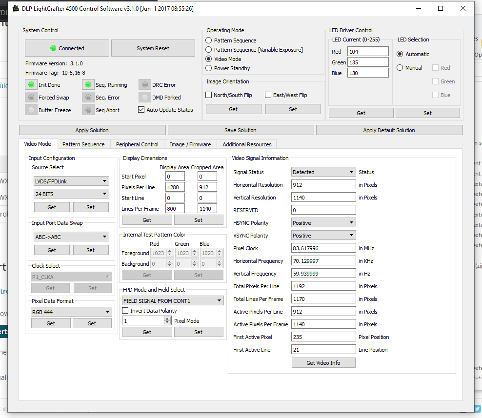

We use the DLPC350 in conjunction with the DLP4500FQE, where we stream pattern information to it using the LVDS interface running in pattern mode (so that we can get pixel accuracy).  This has been working fine for some time.

In video mode it now shows:
where it is showing Horizontal resolution of 913 instead of the expected 912.
The windows display settings are correct, and how the resolution of 912.

  • Appologies, i don't think the images attached properly.  Here is how it looks on another system which is using the old DLP4500FQE.  The Horizontal resolution is 912 as we expect.

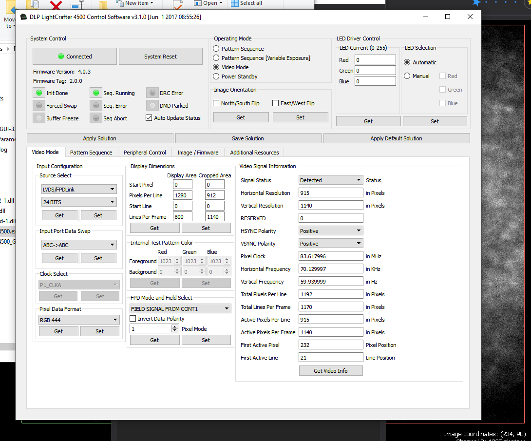

    ANd here is how it looks on the new system, where the horizontal resolution is incorrectly picked up as 915   (we have also seen it identified before as 913 as i mentioned above).
    A thought was that perhaps we need to update the EDID structure on our custom hardware to support the new part?  If so can you tell us how it should be changed?

  • Hi Philippe,
    Yes, we have a custom board configuration but this has been operating without any problems for well over a year.  This problem has only started recently with the upgrade to the new DLPC4500.
    Please note, that we either user our own software to talk to the DLP350 over USB, OR can also use your LightCrafter GUI application.  Both work.  In addition, both of them report the different horizontal resolution that we are seeing.

  • We have developed our custom software for the old DMD.
    Then we have tried to run the same custom software with the new DMD, and had the resolution problem. (everything else e.g. our custom DPLC350 carrier board, is unchanged)
    We have tried to run the new DMD with the old lightcrafter GUI version (3.1) and had the same problem.
    We have tried to run the new DMD with the new lightcrafter version (4.0 i think?) but also had the same problem.
    We had also ran the DLPC350 with the NEW DMD using the old firmware revision (3.1), and the latest one (4.1) but both show the same issue.
    Our custom EDID is also unchanged from when we were using the old DMD.
