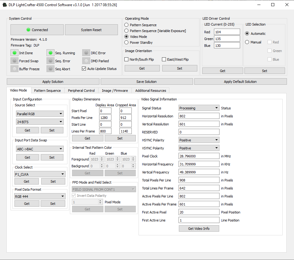

We are trying to get a video stream of Raspberry PI 4 desktop to DLP's micromirror via hdmi.
Somehow, GUI shows that everything is OK and there's no problem with video signal capturing, but there's still an issue of no video/picture displaying on the DLP's mirror.
Also, horizontal resolution and vertical resolution are detected with a slight addition in pixels, GUI shows that resolution is 802x601, but HDMI model is configured to be 800x600 60fps mode
broadcast, and there is no trouble with displaying Raspberry's desktop, when it's connected to other devices. We also tried different kinds of DLP's supported resolution, but the trouble is constant.
I attach screenshots to be more clear with my problem. We are new to this and it's a struggle for us to solve this kind of trouble.
Any help will be highly appreciated, thank you!

  • Hi Alexander,
    Can you please confirm that the raspberry pi output includes blanking intervals more than specified on the DLPC350 Datasheet  section 6.11 Video Timing Input Blanking Specification?
    Also, could you please try connecting the LCR4500 EVM to another source (such as HDMI out from laptop/ PC) and see if you can get image on the wall?

  • Hi Alexander,
    Can you please try with another source such as your laptop/PC? That will confirm once & for all if there is something wrong with your EVM. Also, did you modify the TI FW Image (adding custom Images, I2C Settings, Config INI etc)  in any way before flashing it on to the device?
  • Hi Hirak,
    Yes, I've already tried to connect DLP to another source - and the streaming was successful. Also, I did try to add custom images but nothing was displayed
    Alexander
  • Hi Alexander,
    could you kindly note the blanking information while connected to the device with successful streaming and apply them to your RPi module to see if that works?
    Also, while modifying official FW kindly note the following:
    DLPC350 FW v4.0 and below should be modified ONLY by LCR4500 GUI v3.1.0  and
    DLPC350 FW v4.1 should be modified ONLY by LCR4500 GUI v4.0.0
    mixing incompatible GUI and FW may generate corrupted FW.
  • Hi Hirak,
    Thank you for your answer and providing information about types of GUI, it really helped. I've installed correct version for FW v.4.1., but still there's no stream on DLP and resolution's still to be inaccurate.
    Blanking information from the device with successful streaming is attached, still no result from applying same params to RPi module.
    Alexander
  • Alexander,
    I noticed that your Raspberry Pi config.txt uses the old timings (28 MHz), and that the above timing does not work. What happens when you use the above timing configuration on the Raspberry Pi:?
  • Philippe,
    Thank you very much for your help, I've managed to resolve my issue with changing config input interfaces.
    Alexander
  • I will add a short guide of how I managed to resolve the issue.
    First of all, I made a custom EDID model that is able to support 912x1140 because of an empty EEPROM on our electronic board. Then, enabled i2c (overall in raspi-config) and edited config.txt in /boot to get control over HDMI's i2c bus with following line "dtparam=i2c2_iknowwhatimdoing".
    After all these steps, I was able to detect the second bus and 0x50 with an empty EEPROM, so, I made a script using Python to write EDID model in EEPROM.
    Also, I commented out all the lines in config.txt that are connected with forced HDMI output on RPi. hdmi_group=2, hdmi_mode=87, hdmi_cvt=912 1140 50 is all you need + I switched to newer GUI as Hiraak was advicing.
    I should mention that I've switched to RPi3 for that.
    Best of luck,
    Alexander
