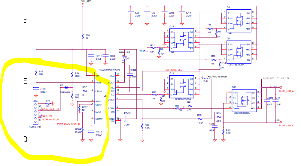

  • Should  B_EN  connect dlpc4422 bule_en pin ?  Why it is not used ?how connect this interface to dlpc4422 pins
    In the schematic, U9 is a 6 pin header that was intended to allow for easy measurements and also to allow the user to easily open/close the connections between the control signals and the driver.
    You only need a jumper over pins 5 & 6 to connect the enable signals to the driver SDIM input.
    Same thing applies to Pins 1 and 2. Placing a jumper will ensure the driver is turned off when the other channels are on.
