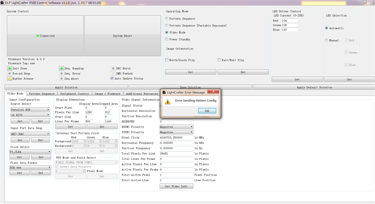

My DLPLCR4500EVM doesn't work,because it show “Error Sending Pattern Config” when i apply the sequence solution. I think the ".ini" file is ok, because a week ago, it was right to use. I don`t know how to deal with the problem.

I see that your EVM is connected based on your GUI images.
Do you have communication with your board? Are you able to use the "Get" buttons? Does everything else work outside of the .ini file?

I didn't change pattern or configurations.I give you my bin and ini file.ini and bin.zip

I was able to download your .BIN and .INI file and both load your .BIN and send the .INI solution successfully to the DLP LightCrafter 4500 EVM. In my case I did not encounter any errors when attempting to send the pattern.
The only thing I could note here is that you are using v3.1.0 of the LightCrafter 4500 GUI software, and I am using v4.0.0. I am also using Windows 10.
You may want to try downloading the latest release before trying again. If that fails, consider trying the same on a different PC.
