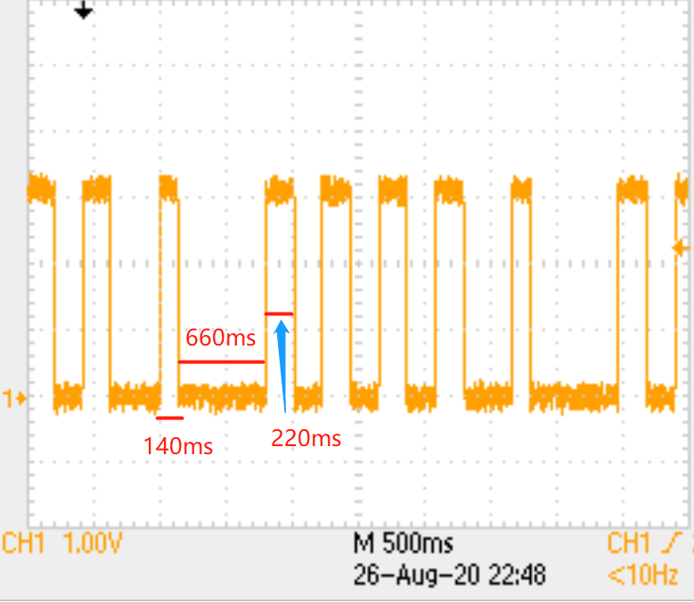

  • Hi Byron,
    Can you help me with following details.
    1. Is it possible to capture D5 (red led) pulse in oscilloscope and share the screenshot.
    2. Can you capture controller UART (J6) debug messages and see if any error is printed when red led blinks.

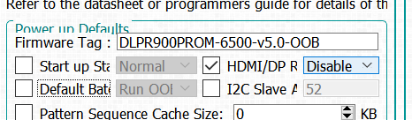

    3. Since  IT6535 is not used, can you create Firmware disabling HDMI/DP port in power up default, load new Firmware and check if problem is resolved.

  • Hi, Shivakumar
    Same state
    Byron

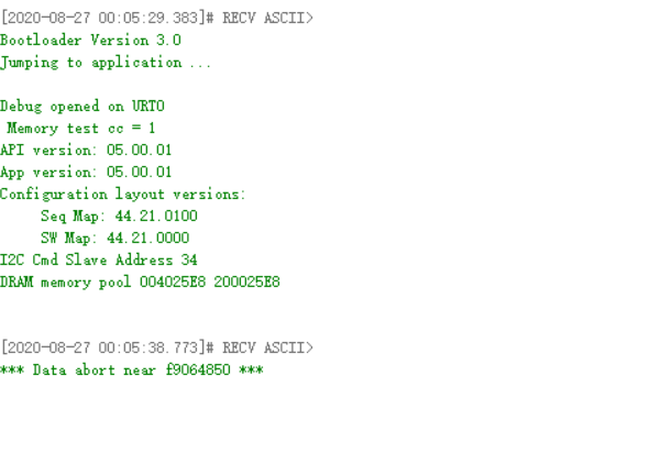

  • Hi Byron,
    Looking at the Debug Message, this error is reported due to invalid memory access.
    To further debug, can you provide following information.
    1. Are you loading the TI Released firmware "DLPR900PROM-6500-v5.0.1-OOB" without doing any modification. Please share the Firmware you are using.
    2. Is this issue is observed with only this Board or in all the boards.
    3. Can you share exact Part number of the External flash Chip been used and "FlashDeviceParameters.txt" file (DLPC900REF-SW-4.0.1\DLPC900REF-GUI\Flash). What is the total External Flash memory size.
    I will also send you Firmware with higher level of debug enabled. Please load this Firmware and Capture the debug logs.
