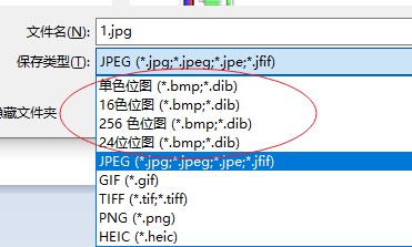

Second Problem: If I use the image which will be flashing, what requirements should the picture meet. For example, I use the 1152x576 resolution of image which meets the manual, but I don't know what format is needed (jpg, bmp?) and the image should be 24 bit bitmap or 256 color bitmap or 16 color bitmap?

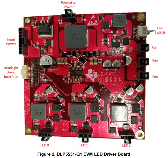

Fourth Problem:  Can you give me the schematic diagram, we need it when we develop the DLP system. For example, we connect our own fan, we need to know the electrical parameters. we need know the voltage and current of the fan and the definition of the Pins.

    Problem 2) Source Image File Format :
    External Video Source : No requirement for file type, as long as it can be sent via HDMI from the source device.
    Splash Screen acceptable file type: GIF, BMP, PNG, JPG.

  • Hello Chen,
    These files should be available on the EVM product page on TI.com soon, but I have also granted you access to the EVM documentation and schematics page in the meantime. You should receive an email with instructions for access.
    More info on the fan voltage and current limits, and other EVM information can be found in the EVM users guide, https://www.ti.com/lit/ug/dlpu067/dlpu067.pdf.
    There are no requirements on the content of the splash image, just the resolution should be supported as in the DLPC230-Q1 datasheet or the EVM user guide, section 1.2.4.  It will typically be easier to display images over HDMI for rapid prototyping. But when you have the EVM and need to re-program the splash images, respond to this thread or post another question and we can give you access to the required software.
