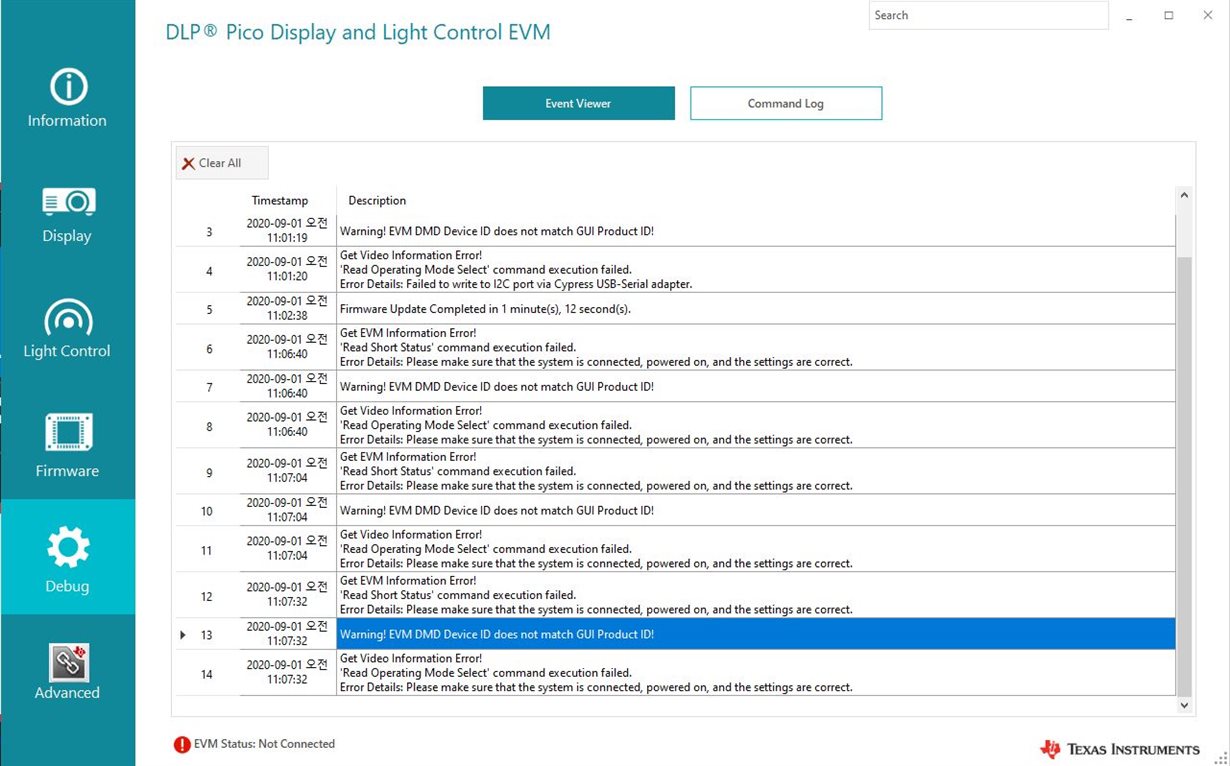

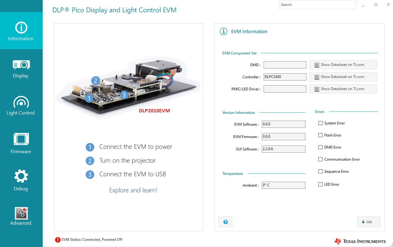

Currently, I am testing the operation of various DLP engines with DLP2010EVM-LC.
The main phenomenon is that the changed DLP engine does not operate differently from the existing Ti DLP engine.
1. EVM <- new DLP engine (DMD, LED cable connection)
2. Power cable connection, power on
3. DLP engine does not work

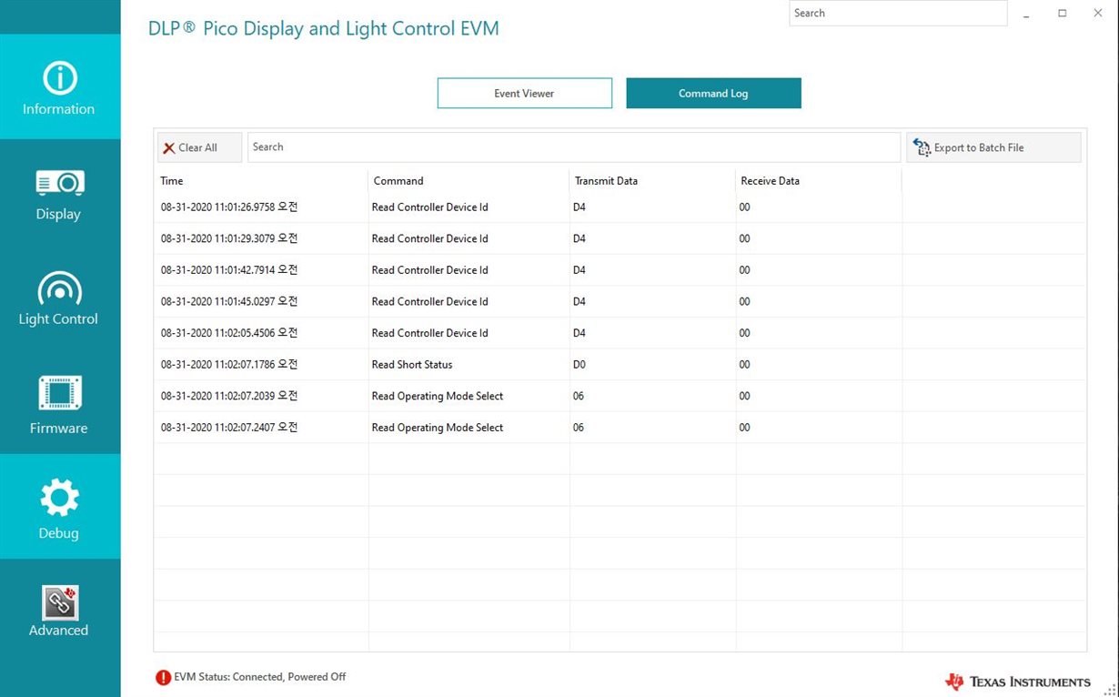

4. Get EVM information on Information
     Error message:
     Get video information Error!
     'Read Operating Mode Select' command execution failed.
     Error Details: Please make sure that the system is connected, power on, and the setting are correction.
5. Error message on EVM: !EVM Status: Connected, powered off
6. Event on Debug:
     Get EVM Information Error!
     'Read Short Status' command execution failed.
      Error Details: Please make sure that the system is connected, powered on, and the settings are correct.
      Warning! EVM DMD Device ID does not match GUI Product ID!
Please advise on what can I do to deal with this phenomenon.

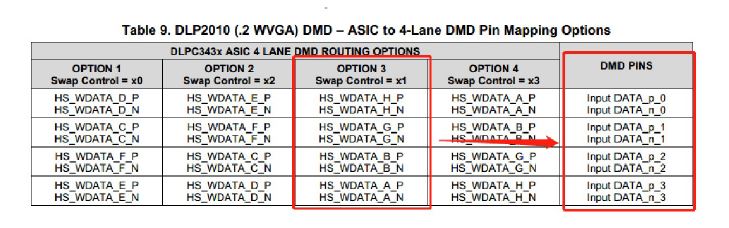

  • So, where can I download the firmware version for the previous DMD part number to work?  Does it work if it is version 7.x?
  • The picture above is the pin mapping sent by the manufacturer.
    Can the pin mapping be specified when applying the previous firmware requested above?
    In conclusion, what is expected is that we need a firmware that can be driven by DLP2010EVM-LC + DLP2010 0.2 DMD + pin mapping3.
  • Also, I am curious what the Option means in Pin Mapping.
    Yes; Each data path? Or the DLP resolution change according to the option, etc.
  • Yun,
    1. Yes, I can share the required firmware with you ( DLP2010EVM-LC + DLP2010 0.2 DMD + pin mapping3). Please share you email ID linked to myTI account.
    2. Also, I am curious what the Option means in Pin Mapping. >> Each option corresponds to a different datapath.
    Mayank

    I update New informations
    DMD   DLP2010A, 0.2" DMD
    DLPC DLPC3470
    PMIC/LED Driver DLPA2005
    EVM DLP2010EVM-LC(7.3.1)
    Pin mapping Option 3
    Firmware version Cannot be confirmed because communication is not available
    DLP Engine Ti Asiaoptic DLP(Option 3)
      Iview 830L-ZB
      Elepn U206A
    GUI   V2.2.0.6
    Problem 1 Host IRQ does not go low (compared to normal operation Asia DLP)
    ASIC auto-initialization failed?
      2 DMD Device ID Matching X

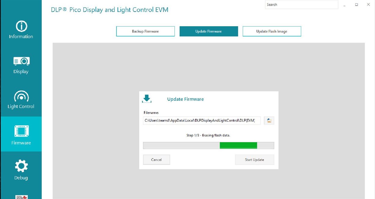

      3 Firmware update unavailable
      3-1 Update firmware
    step 1/3-Erasing flash data has been running for a long time and does not move to the next step
        Firmware Update Failed
    Normal operation DLP and LED status comparison
      D1 Host IRQ D2 Resetz D3 PROJ_ON
    Ti(asia DLP) OFF OFF ON
    E Company ON OFF ON
    i Company ON OFF ON
    Please let me know how I can do it in this matter.

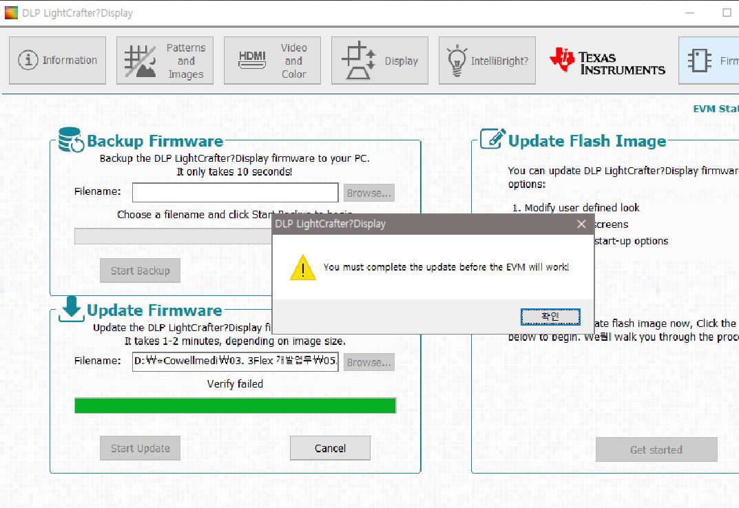

  • Dear
    Thanks for sending the firmware.
    In the GUI Software 2.2.0.6 we used previously, the update was not possible because the DMD connection was not available. I went to the Ti Forum and tried to install the firmware as there was a way to update the damaged firmware image from DLP Lightcrafter 7.4 to SPI.
    The update installation process is EVM+DLP Engine connection, Data Cable connection -> Switch Off -> Power Supply ON -> Lightcrafter 7.4 execution -> Firmware update
    The result is as follows.
      Firmware Version Ti 7.3.1 F/W(option3) iview 7.3.1 Option 3 Elepn 7.1.3(option 1)
    dpp343x_7.1.3
    Elepn 7.1.3(option 3)
    dpp343x_7.1.3
    Ti
    Engine
    F/W Update O O O O
    Whether DLP works O O X X
    Elepn
    Engine
    F/W Update X(Verify Failed) X(Verify Failed) X(Verify Failed) X(Verify Failed)
    Whether DLP works X X X X
    Iview
    Engine
    F/W Update X(Verify Failed) X(Verify Failed) O O
    The current problem is that the firmware is not updated in the two 3rd party engines themselves.

  • Dear Mayank
    Always thank you for your kind answer.
    1. I understood well.
    2. In the case of DLP2010LC 2.2.0.6, I watched the Erasing Flash Data process for more than 20 minutes with SW1 turned off as follows, but the update is not possible because it does not proceed to the next step.
    Therefore, I tried the firmware in DLP Lightcrafter 7.4, which can be directly updated to SPI, and the result was (1/3 Pass -> 2/3 Updating -> 3/3 Verifying = Verify failed).
    To summarize the problem largely
    1) DMD ID mismatching
    2) Firmware update unavailable (DLP2010LC GUI 2.2.0.6 & DLP Lightcrafter GUI 7.4)
    3) Host_IRQ remains high

  • Dear Mayank

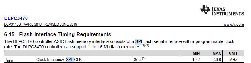

    As a result of testing using a common Ti(asia) DLP engine's flash memory (using Ti flash), it was confirmed that the firmware could not be updated due to a problem with the No. 1 DLP manufacturer and No. 2 DLP manufacturer flash.
    Also, one company's DMD did not work, and the other company's DMD worked, so the following results were obtained.
      Ti Optic Engine No. 1 DLP Manufacturer (I) No. 2 DLP Manufacturer (E)
    DMD operation O X O
    Flash memory operation O X X
    Flash memory  64Mbit 16Mbit 16Mbit
    Flash memory clock frequency 1 I/O: 104MHz with 8 dummy cycles
    2 I/O: 86MHz with 4 dummy cycles for 2READ instruction
    4 I/O: Up to 104MHz
    104MHz clock rate for Standard SPI
    80MHz clock rate for two data bits
    80MHz clock rate for four data bits O31:O32
    133MHz Single, Dual/Quad SPI clocks
    266/532MHz equivalent Dual/Quad SPI
    <Question>
    1. Like the data sheet above, 16Mb, 36MHz is supported, but is there a reason to use a specially higher specification flash memory?
    2. Since there is a problem with the flash memory, I try to replace the flash memory on the EVM board or the DLP engine (both manufacturers 1 and 2 have flash memory attached to the FPCB cable). Are there any recommended products?
    3. If the specification is higher than the above data sheet, is there any problem with what kind of flash memory is installed? (Similar size)
    please answer about my question.

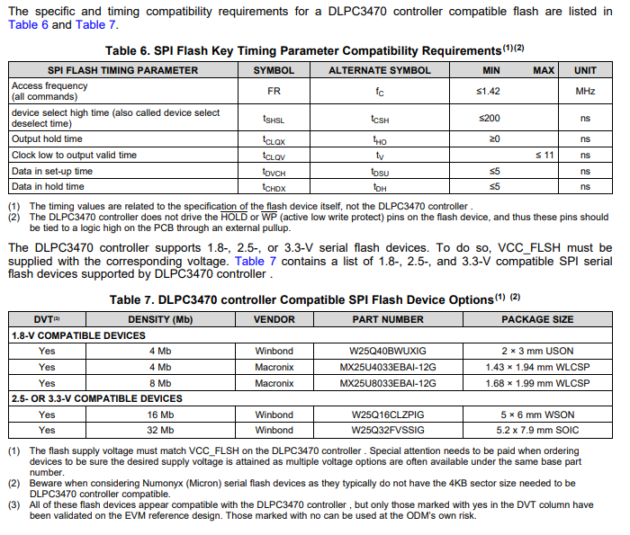

  • Yun,
    I believe the team is still working this issue and should get back to you within a few days. Thanks for your patience.
    Philippe Dollo
  • Yun,
    Thanks for sharing this information. I am glad that you have somewhat found out the root cause of the issue.
    Please refer to the attached image which lists down the flash devices which are compatible with DLPC3470. The image also gives a detailed information of the SPI Flash compatibility requirements -
    My responses to your queries are as follows -
    1. Like the datasheet above, 16Mb, 36MHz is supported, but is there a reason to use a specially higher specification flash memory? >> I might not have understood this query clearly. Higher Size and speed can be the reason behind this.
    2. Since there is a problem with the flash memory, I try to replace the flash memory on the EVM board or the DLP engine (both manufacturers 1 and 2 have flash memory attached to the FPCB cable). Are there any recommended products? >> Please refer to the above image to see the list of recommended products.
    3. If the specification is higher than the above datasheet, is there any problem with what kind of flash memory is installed? (Similar size)
     >> I would recommend you to choose a flash device from the list mentioned in the image as they have been validated with on the EVM. We cannot guarantee the compatibility of the flash devices that have not been validated with the EVM reference design.
    Let me know if you have any more queries.
    Mayank
  • Dear Mayank
    I'm glad to finally know how to fix it.
    The reason was that the size of the FLASH installed in the DLP engine (2MB) was too small to update the large firmware (2.31MB).
    The manufacturer sent a reduced firmware (1.63MB) and tested it, and it works.
    Therefore, we plan to proceed with the development by directly installing the large-capacity FLASH on the EVM.
    I am curious to see which data can be referred to for additional ways to change and modify the firmware (reduction of firmware capacity, system settings, etc.)
    If you know, please let me know.
    Thank you for your help.
