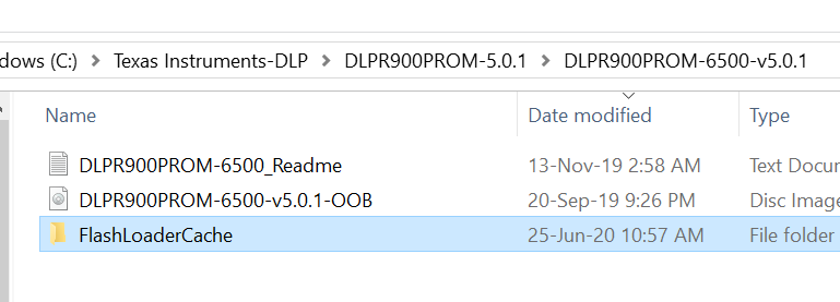

    3. Delete "FlashLoaderCache" Folder located in Firmware image folder.
    4. Power up the board, Open GUI, Select DMD as 6500 and load "DLPR900PROM-6500-v5.0.1-OOB" firmware image.

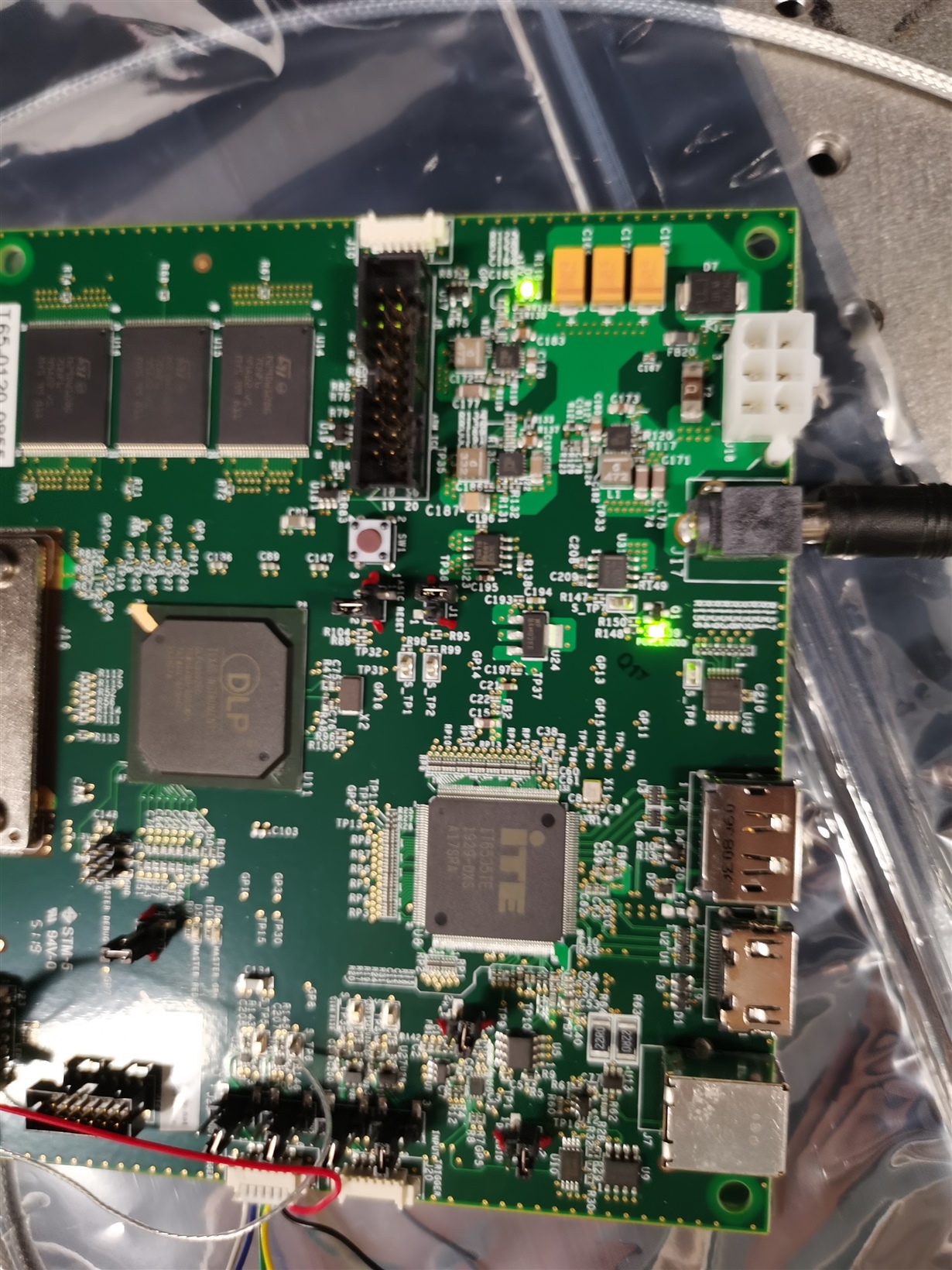

    Have you done any experiment or modifications on the DMD board. Please share its pictures.

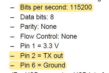

    Serial port outputs at J6 are 3.3-V TTL level and require an external transceiver to convert to RS232.
    Pin 2 is TX and Pin 6 is GND.
    You need serial terminal software like "Terraterm" or "Putty".
    configure terminal with below settings.
    – Bits per second: 115200
    – Data bits: 8
    – Parity: None
    – Flow Control: None

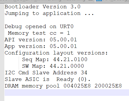

    If connections are made proper and Serial terminal software is configured proper, you can expect to see below message printed out when system boots.

    I add some trigger wire at J24 on our original DMD board, I don't think it's the reason because the DMD work well after connecting trigger wire. I forgot to take some pictures and I will fetch it up tomorrow.
    I don't have a transceiver to convert J6 to RS232 now and I will post the Serial port debug logs after I get a transceiver. When using serial terminal software to debug, should I place Boot hold Jumper or just connect the PC with RS232 directly?

    You can use similar TTL-232R-3V3 converter to capture serial debug logs.
    Shivakumar

    Thank you again and sorry for replying so late. I have tried the DMD on another board for several minutes, it worked normally and DMD was not excessively hot. However, I still want to find the reason why the previous board can't control DMD. I bought a converter to capture serial debug logs, and I will reply as soon as possible if there any updates.
