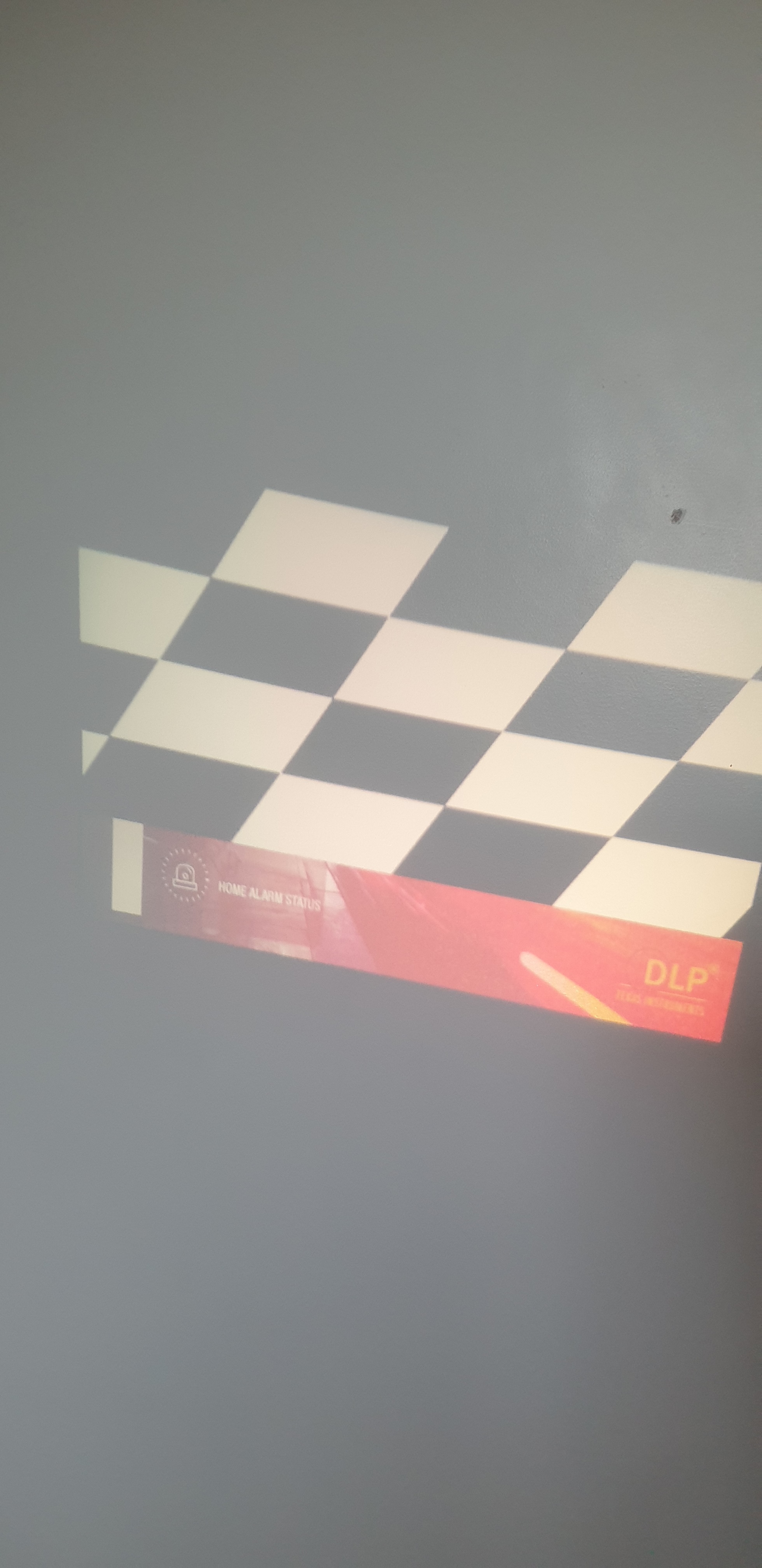

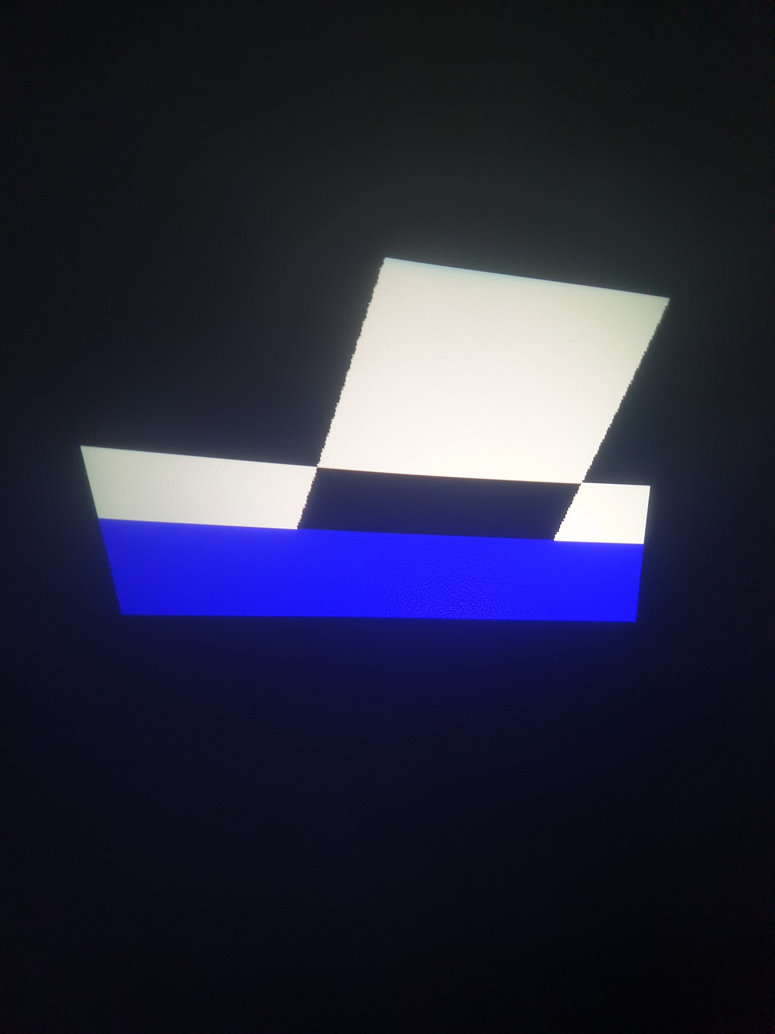

Hi, I'm trying to output from dlp2000 evm using a custom it6801 board but I only get blue screen or red screen. If I switch the screen to internal test patterns, the bottom bit will still show flickering splash screen, at this point It will freeze and will not switch back to splash screen or to input source. I tried it with raspberry pi previously and I get the same result.   et blue screen or red screen (see images attached). If I switch the screen to internal test patterns, the bottom bit will still show flickering splash screen, at this point It will freeze and will not switch back to splash screen or to input source. I tried it with raspberry pi previously and I get the same result.

    when i send the commands the screen goes blue or red.
    if i switch to internal test pattern the bottom bit will still show flickering splash screen.

  • i'm using beaglebone black for i2c commands now, i also used arduino and raspbery pi but still no image output.
    sometimes i get solid blue screen some times it stays on splash screen

  •  if I give command for external patterns, it displays external pattern but bottom bit still be's blue. This happens even if the rgb source is disconnected
