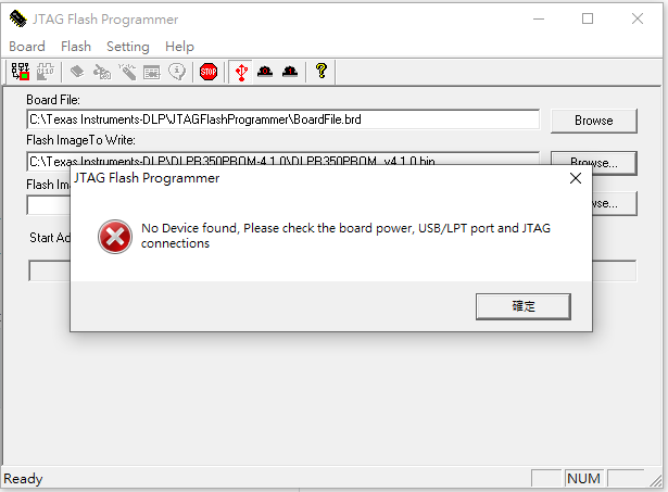

When I use JTAG to re-program the DLP4500, my JTAG Flash programmer will show rhe error.
(i have checked the line plugged correctly several times)
Hi User,
Welcome to TI E2E forums! From the picture Looks like you are connecting your JTAG cable to the wrong port (J11). Kindly note that the correect JTAG port is J25 (on the bottom side of the PCB). You can look at the schematic for more information. Please also look into the DLP LCR4500 Flash Programming Guide for detailed step by step info on using the JTAG Tools.
