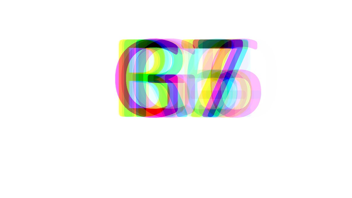

    For example, if we send the following RGB image (made of letters 'R0' in case of bitplane R0, 'B0' in case of B0, etc.):
    We observe the corresponding 'letters' for all bitplanes except G0 and R1. We fear that we have damaged some electrical components (capacitors?) relative to G0 and R1, but we do not know which elements to test as the manual of DLPC900 is not very exhaustive.
