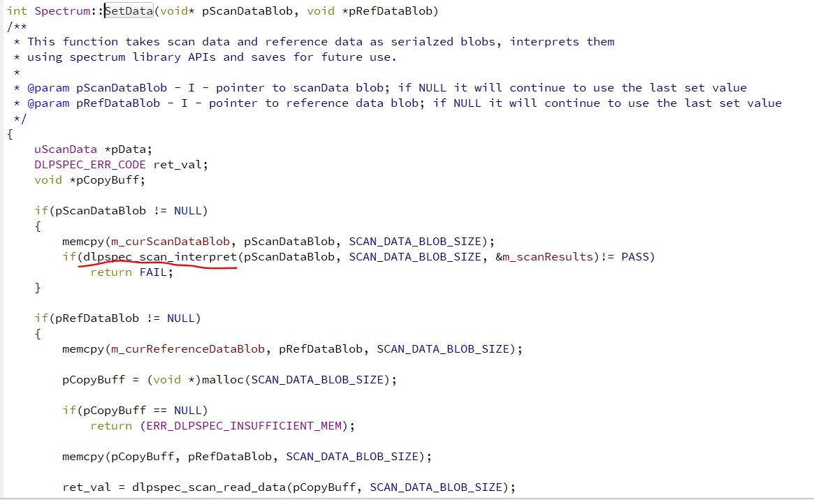

I've done some modification on the Spectrum library, and upload the NIRscanNano.bin file to the device successfully. I want to know how it works. From your description, I need to debug the code using the CCS.
I looked through the user guide, but didn't find how to debug the code. Could you please tell me more detials about how to debug using CCS? I 've got the following questions:

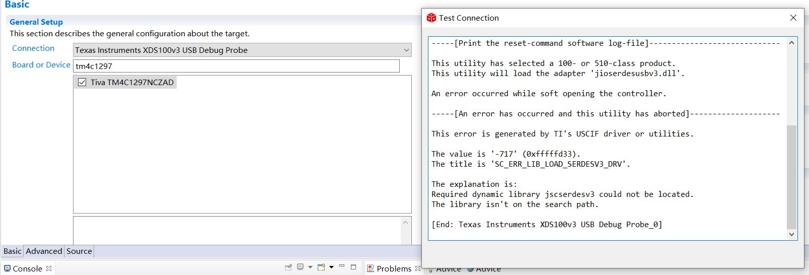

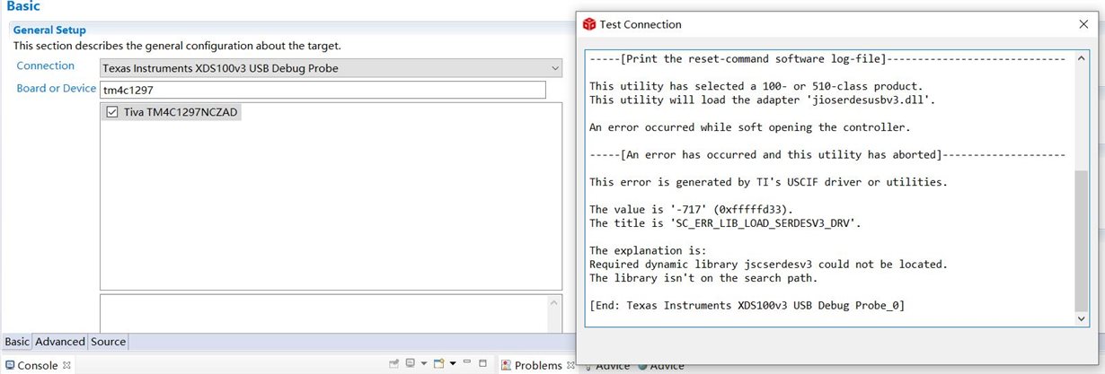

Thanks for your apply. I meet some problem when trying to connect to the device before debugging.
[Start: Texas Instruments XDS100v2 USB Debug Probe_0]
Execute the command:
%ccs_base%/common/uscif/dbgjtag -f %boarddatafile% -rv -o -F inform,logfile=yes -S pathlength -S integrity
[Result]
-----[Print the board config pathname(s)]------------------------------------
C:\Users\ASUS\AppData\Local\TEXASI~1\CCS\
ccs930\0\0\BrdDat\testBoard.dat
-----[Print the reset-command software log-file]-----------------------------
This utility has selected a 100- or 510-class product.
This utility will load the adapter 'jioserdesusb.dll'.
An error occurred while soft opening the controller.
-----[An error has occurred and this utility has aborted]--------------------
This error is generated by TI's USCIF driver or utilities.
The value is '-716' (0xfffffd34).
The title is 'SC_ERR_LIB_LOAD_SERDES_DRV'.
The explanation is:
Required dynamic library jscserdes could not be located.
The library isn't on the search path.
[End: Texas Instruments XDS100v2 USB Debug Probe_0]

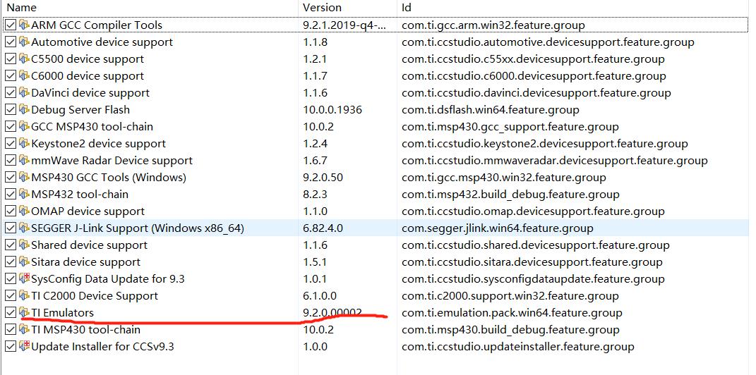

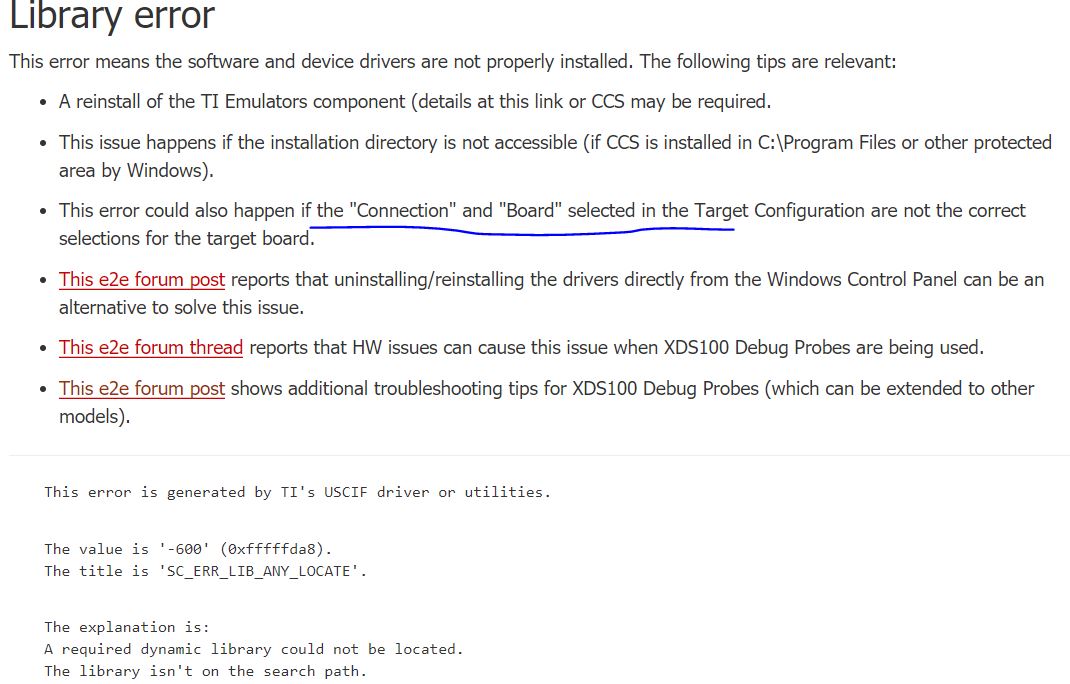

How can I deal with this issue? I try to find the solution on the internet, and find some guidance at: http://software-dl.ti.com/ccs/esd/documents/ccsv7_debugging_jtag_connectivity_issues.html#library-error
I've check the drivers and update the XDS software, but it doesn't work.
How can I deal with this issue? Do I choose the correct "Connection" and "Board"?
