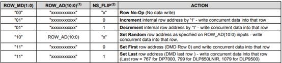

For my application, we would like to control DMD(DLPLCRC410EVM) with our program.
According to User's guide and Programmer's guide, the way to make mirror show assigned patterns is loading the data first and then passing reset signal.
Before running the program, I want to check the correctness of my logic. The followings are functions I am going to used.
1. get_usb_speed --> check the connection of fpga board.
2. load_control --> start controll DMD
3. set_tpge_enable == 0 --> stop sequence
4. clear_fifos --> before passing image to DMD, clear datas in buffer.
5. set_row_md
6.set_row_md_addr --> set the addr of image
7. load_data --> load image (size == 400 * 1280)
8. set_blkmd
9. set_blkad --> give reset signal
Thanks for your help in advance.
David

    This looks almost correct except there is one other step.
    After setting any row or block modes/addresses you must call load control.  Step 2 may not be needed, but keep it.  If you find that it is not working correctly, try calling load control three times.
    In your sequence try calling it after step 6. and step 9.
    Fizix

    You must load the entire width of the array and load 1/3 of the data to the APPS_FPGA, then send it to the DMD.  Do that two more times letting the row counter increment automatically.  This will result in all of the DMD being loaded, then you can issue a Global Reset. (i.e ROW_MODE "01")
    When you wish to load the next image, you must set the first row (i.e. ROW_MODE "11"
    Fizix

  • Hi Fizix,
    I have successfully found the bug.
    The issue is the data size. I originally passed 400 * 1280 array two times with load_data function on DMD.
    However, I found that although I pass 50 * 1280 array with full "1" in unsigned char type(i.e. each element is 255), almost half of the mirrors would change its physical type.
    Then, I shrink the origin pattern(divide X axis value, 1280, by 8) , which make the pattern size from 800 * 1280 to 800 * 160, load it, and the mirrors show the correct pattern!
    If I got it right, this mean each unsigned char element(8 bit) would correspond to 8 mirror instead of 1. Is my idea right?
    David
  • David,
    Sorry for the delays.
    Your understanding is correct.  The data is binary.  So each char element represents on or off for 8 mirrors.
    Great work!
