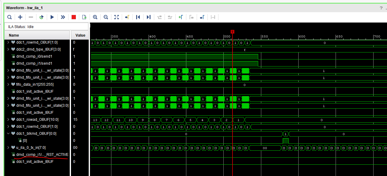

DLPC410: not receive rst_active signal
Part Number: DLPC410
Other Parts Discussed in Thread: DLP9500
Working with custom board and custom flex cable towards DLP9500 (controller is DLPC410ZYR, driver is DLPA200PFP, PROM is DLPR410AYVA).
I am receiving the init_active signal but after the frame is sent, not receiving any rst_active signal from the board. blk_md is sent as needed by the FPGA.
I've disconnected the DLP and flex cable, still receiving init_active from the controller, so obviously this does not help.
Any help will do. I'm currently stuck.
