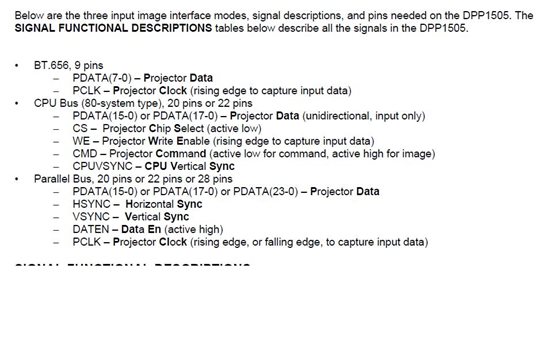

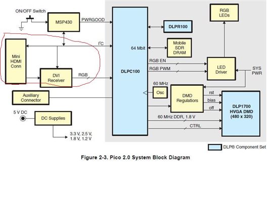

Hi,I want use Dm365 LCD interface to control Pico2 kit, DVI board will removed.
I know DPP1505 three input method, Parallel RGB may be connected with LCD interface. I want to know
1: if I select parallel RGB input interface, how other pins(CPU I/F and BT565) are connected? eg.CS, WE,CMD,CPUVSYNC?
2: DATEN is conntected with LCD_OE or LCD_Field (DM365 LCD Interfacepin)?
