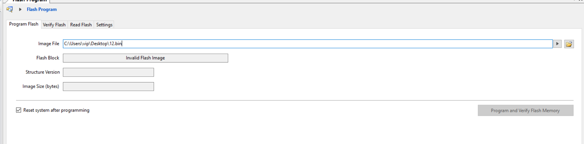

I investigate in the E2E, find If I use the splash screen function to display,i must use the DLP Composer tool to converse the picture to .bin format. conversed by other tools is useless.

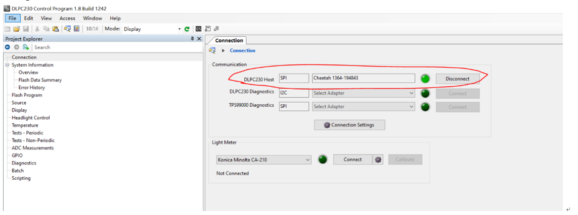

the  picture show the SPI is connected,but failed to burn

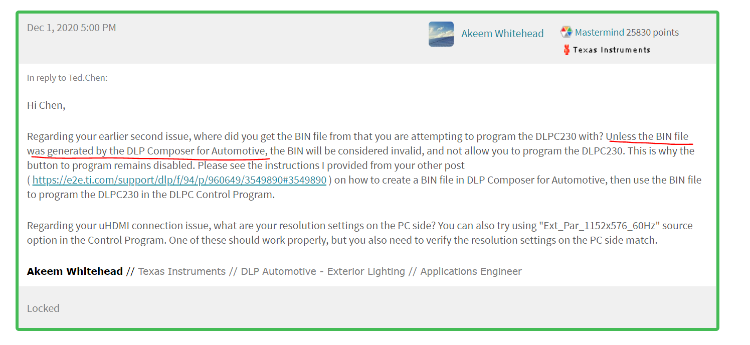

Previous responsed for the question in E2E
