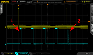

With our DLPDLCR4710EVM-G2 module we are trying to get the most accurate frambuffer timing. To check we are on the right track we are using a variant of this code (running on Linux - Debian 9) to set the screen blue for a frambuffer and then black into the next one.
In the next images we see in Yellow the ITE6801_VSYNC_OUT, pin 1 J4 and in Blue the DLP response measured with a photodiode power-meter.
In the images we see a delay just before we set the framebuffer to blue (1) and also a delay in the next one, when the framebuffer should be black (2).

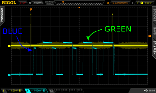

For reference, we use the same setup but this time the framebuffer is "cyan" (green and blue), in this case the green color wave looks perfect, but the behavior in the blue is equal to the one seeing above.
Do you guys know if this is a hardware error or if it is a software issue?
