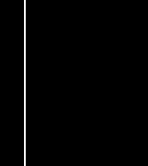

  • Hi there , can you explain what a walking slit is ? I should e able to help . I am now very familiar with the  1440 mode .
    I have a shell script which I'll post which will run  from the standard beagleboard angsrom image with no modifications .
    With regards to encoding the images , if you want more than 24 frames in your animation you will need to use a MOV animation using the Animation codec from apple as all others I tried lost the ColorSpace information due to image ccompression.
    If you just need to loop through 24 frames at 1440 fps , you can create a tiff , or png image and  if the  frames do not overlap one another simply code each sub frame by drawing it using 24 colors from an BRG pallatte that each have a single bit set.
    Eg
    10000000 00000000 00000000
    01000000 00000000 00000000
    00100000 00000000 00000000
    I can send you something more detailed on Monday when I'm back at work.

    Hi Gavin,
    Thanks for your help! I am looking forward to your newcoming post and website!
    A walking slit is like when you play piano just press one key at a time from left to right. The pressed key will be white, and the rest is black. So it is 1-bit. See below:
     This is for structural light application.

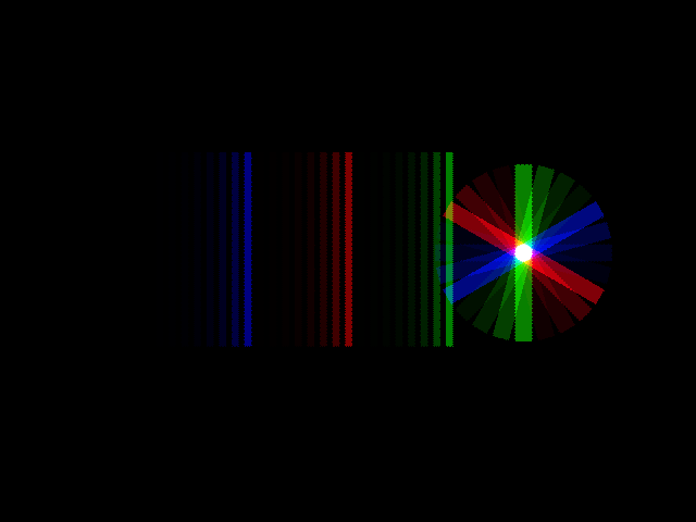

  • Heres a quick example of what a single RGB frame looks like with 24 frames encoded in it.  If you display this on your pico in 1440 mode, you will get a line moving accross the screen through 24 positions , and it will cross the screen 60 times a second.  The rotating line on the right will rotate 60 times a second through 24 positons, it shows a good example oif what happens when the lines overlap, creating lovely rainbow colors!
    Note, that some of the lines are hard to see, as each gets exponentially darker than the previous one. Use a color picker in a paint program to get an understanding of each color and a better feel for the process.  The PICO will seperate each bit patten in sequence playing dark blue through to light blue, followed by red, then green.
    if you cut and paste the following code into a file and save it with a .sh extention, you can then run it as a shell scipt on the beagleboard, and it will set the Pico 2 to the correct mode.
    To Create a walking line, you would just code an animation that moved a line accross the screen and cyce though the color palette as above.

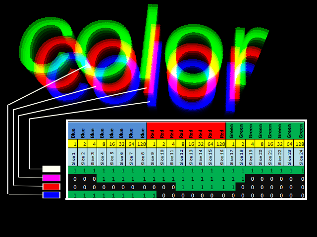

  • Heres another image, which I made for our upcoming website. It shows the actual bit patterns for each slice of a 24 slice frame, and the order in which you need to code them.
    I used processing 1.5.1, as I've had some issue running some of my old code in 2.5.   Both should work if you are writing from scratch though.  I can't share my exact code as part of another confidential project at the moment, but processing is very straighforwards, and I can tell you that for this image. I read in a 24 frame monochrome MOV file which had each frame to be encoded. Then looped through each pixel 24 times, and created a new output pixel by combining each bit value in turn using a look up table which looked like this.

    The bit where i write out the new pixel value looks somehing like this
    output.pixels[i] = output.pixels[i] | (myMovie.pixels[i] & 0x00FFFFFF & numbers[framepos]);
