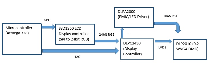

I'm about to start my electronic degree project and I have been looking over the idea of this the DLP2010 a few times but never had the time to play with it.
With that said my project idea would be to create a DPL2010 driver and display card to output simple text and graphics using a microcontroller like the Atmega 328 via bluetooth , think of it as a open source Google glass that your average Joe can enjoy :).
The main reason for this post is to get some advice and even double checking of the driving of the DLP2010.
Below I have quickly created a simple block diagram of the system I could use to drive the DLP2010:
Any input is welcome :)
Thank you for your time.
