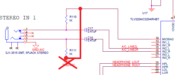

    I have been following this thread because Ive had trouble powering a "stereo" microphone. I have made the required changes as mentioned above... and I am only able to power half of the microphone, if that makes any sense.  the microphone I am using is actually two different microphones that tie into a single TRS connector... each microphone is tied to a respective channel (left or right). The reason I am working with this microphone is because a two microphone array is required and the C5535 ezdsp does not have two input jacks.
    As far as the on-chip hardware is concerned, I noticed that only ONE channel is powered at all times with the default voltage is 1.25V. I looked at the schematics and it looks like  IN2_L (of the codec) is the only line being powered via MICBIAS. Is the only way to power IN2_R to tie it to IN2_L? If this is the case... this might be an issue because the R&L signals would mix. Any knowledge of this issue?
    Sincerely,
    Jef
  • Hi Jef,
    Without board modification, your stereo microphone will only half work - only one channel (left channel) receives MIC_BIAS...
    To get stereo mic input to work, remove R111 connection to GND-AIC and blue-wire it to MICBIAS (CODEC side of R110) through a 1k resistor.
    This way both R110 and R111 have a 1k resistor path to MICBIAS.
    Hope this helps,
    Mark
