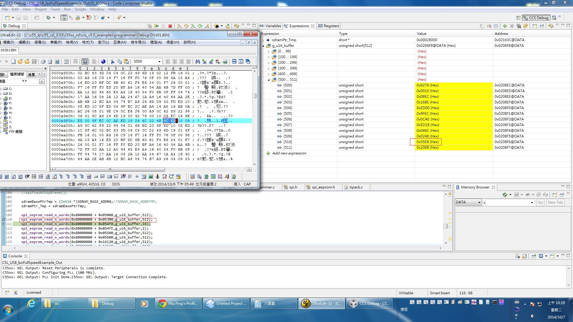

read flash address 0xA9FC is error
We found a bug for read flash value (address 0xA9FC)
Do you have any recommend?
CPU:C5515
Flash : mx25l6406e
Value error : Orginal : 0x6CEB , buffer value :0x55EB
BinFile address: 0xA9FC , flash address : 0x054FE
code:
main()
spirom_init();
spi_eeprom_read_n_words(0x80000000 + 0x05300,g_u16_buffer,512);

SPI_READ_WRITE_N_BYTES(buffer2, count*2, commandbuffer, (sixteenbitdevice ? 3 : 4), SPI_CMD_READ);
#ifdef DISABLE_TI_PACK
for(ii = 0; ii < count; ii++)
buffer[ii] = buffer2[(2*ii)+1];
buffer[ii] |= (buffer2[(2*ii)] << 8);
#else
TI_pack(buffer, (unsigned char *)buffer2, count*2);
#endif
return 0;
