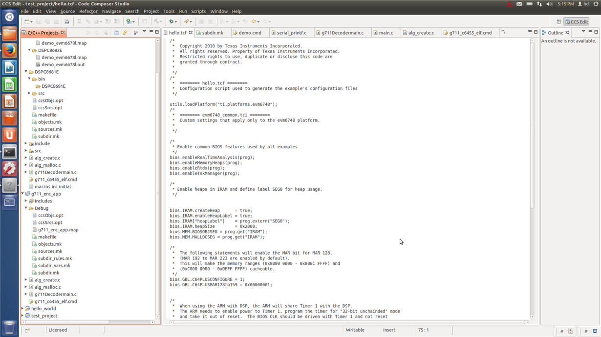

    Can you please attach the screen shot of the error ?
    1)
    You can create a CCS project with the following files.
    C:\ti\c64xplus_g711_2_00_00_000_production\ti\sdo\codecs\g711adec\app\Client\Test\Src
    alg_create.c
    alg_malloc.c
    g711Decodermain.c
    And linker command should be "g711_c6455_elf.cmd"

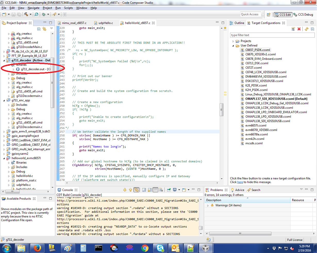

  • Hi Stalin
    Now I am facing very strange problem
    After adding the files and .cmd (as you mention) i am able to compile the code successfully .And log shows that .out created
    but i am not found any .out in the designated location
    I have attach my log file .Please check
    Ajita

  • Hi Ajita,
    I believe, you have downloaded the G711 codec from TI site. That package contains a sample CCS project, you can re-use the same.
    Or, please share your CCS project you created.
    -Venkat
  • Please do "Rebuild project"
    Attach the screen shot of the CCS project window.
    You can also get the codec from this link (latest codec) which has CCS project, so that you can import and rebuild the project.
    software-dl.ti.com/.../index_FDS.html
    Here you can find the direct example with .cproject file which is used to import the project in CCS IDE.
    C:\ti\C64xplus_G711_02_00_01_00_LE_ELF
    C:\ti\C64xplus_G711_02_00_01_00_LE_ELF\packages\ti\sdo\codecs\g711dec\App\Client\Build\Decoder
    Please let us know if you are not able to progress.

  • Hi Stalin,
    I did all steps you have mention in your post and build log shows that .out generated sucessfully (attach the build log)
    but do not get .out file in the location .
    Even I have attach the screen shot of the project .In the debug folder there is no such .out file.
    Ajita

  • Please find the attached log with screen shot.
    **** Build of configuration Debug for project g711_decoder ****
    "C:\\ti\\ccsv6\\utils\\bin\\gmake" -k all
    'Building file: ../alg_create.c'
    'Invoking: C6000 Compiler'
    "C:/ti/ccsv6/tools/compiler/ti-cgt-c6000_8.1.0/bin/cl6x" -mv6600 --abi=eabi --include_path="C:/ti/bios_6_33_06_50/packages/ti/bios/include" --include_path="C:/ti/c674x_aaclcenc_01_00_01_00_elf/packages/ti/sdo/codecs/aaclcenc/app/Inc" --include_path="C:/ti/c64xplus_g711_2_00_00_000_production/ti/sdo/codecs/g711adec/app/Inc" --include_path="C:/Users/Inc" --include_path="C:/ti/xdctools_3_23_04_60/packages" --include_path="C:/ti/xdais_7_21_01_07/packages" --include_path="C:/ti/xdais_7_21_01_07/packages/ti/xdais" --include_path="C:/ti/xdais_7_21_01_07/packages/ti/xdais/dm" --include_path="C:/ti/framework_components_3_30_00_06/packages/ti/sdo/fc/utils/api" --include_path="C:/ti/ccsv6/tools/compiler/ti-cgt-c6000_8.1.0/include" --include_path="C:/ti/bios_6_33_06_50/packages" -g --diag_warning=225 --diag_wrap=off --display_error_number --preproc_with_compile --preproc_dependency="alg_create.pp"  "../alg_create.c"
    'Finished building: ../alg_create.c'
    'Building file: ../alg_malloc.c'
    "C:/ti/ccsv6/tools/compiler/ti-cgt-c6000_8.1.0/bin/cl6x" -mv6600 --abi=eabi --include_path="C:/ti/bios_6_33_06_50/packages/ti/bios/include" --include_path="C:/ti/c674x_aaclcenc_01_00_01_00_elf/packages/ti/sdo/codecs/aaclcenc/app/Inc" --include_path="C:/ti/c64xplus_g711_2_00_00_000_production/ti/sdo/codecs/g711adec/app/Inc" --include_path="C:/Users/Inc" --include_path="C:/ti/xdctools_3_23_04_60/packages" --include_path="C:/ti/xdais_7_21_01_07/packages" --include_path="C:/ti/xdais_7_21_01_07/packages/ti/xdais" --include_path="C:/ti/xdais_7_21_01_07/packages/ti/xdais/dm" --include_path="C:/ti/framework_components_3_30_00_06/packages/ti/sdo/fc/utils/api" --include_path="C:/ti/ccsv6/tools/compiler/ti-cgt-c6000_8.1.0/include" --include_path="C:/ti/bios_6_33_06_50/packages" -g --diag_warning=225 --diag_wrap=off --display_error_number --preproc_with_compile --preproc_dependency="alg_malloc.pp"  "../alg_malloc.c"
    'Finished building: ../alg_malloc.c'
    'Building file: ../g711Decodermain.c'
    "C:/ti/ccsv6/tools/compiler/ti-cgt-c6000_8.1.0/bin/cl6x" -mv6600 --abi=eabi --include_path="C:/ti/bios_6_33_06_50/packages/ti/bios/include" --include_path="C:/ti/c674x_aaclcenc_01_00_01_00_elf/packages/ti/sdo/codecs/aaclcenc/app/Inc" --include_path="C:/ti/c64xplus_g711_2_00_00_000_production/ti/sdo/codecs/g711adec/app/Inc" --include_path="C:/Users/Inc" --include_path="C:/ti/xdctools_3_23_04_60/packages" --include_path="C:/ti/xdais_7_21_01_07/packages" --include_path="C:/ti/xdais_7_21_01_07/packages/ti/xdais" --include_path="C:/ti/xdais_7_21_01_07/packages/ti/xdais/dm" --include_path="C:/ti/framework_components_3_30_00_06/packages/ti/sdo/fc/utils/api" --include_path="C:/ti/ccsv6/tools/compiler/ti-cgt-c6000_8.1.0/include" --include_path="C:/ti/bios_6_33_06_50/packages" -g --diag_warning=225 --diag_wrap=off --display_error_number --preproc_with_compile --preproc_dependency="g711Decodermain.pp"  "../g711Decodermain.c"
    "../g711Decodermain.c", line 139: warning #225-D: function "exit" declared implicitly
    "../g711Decodermain.c", line 149: warning #225-D: function "exit" declared implicitly
    "../g711Decodermain.c", line 155: warning #225-D: function "exit" declared implicitly
    "../g711Decodermain.c", line 161: warning #225-D: function "exit" declared implicitly
    "../g711Decodermain.c", line 211: warning #225-D: function "ALG_create" declared implicitly
    "../g711Decodermain.c", line 217: warning #225-D: function "exit" declared implicitly
    "../g711Decodermain.c", line 378: warning #225-D: function "ALG_delete" declared implicitly
    'Finished building: ../g711Decodermain.c'
    'Building target: g711_decoder.out'
    'Invoking: C6000 Linker'
    "C:/ti/ccsv6/tools/compiler/ti-cgt-c6000_8.1.0/bin/cl6x" -mv6600 --abi=eabi -g --diag_warning=225 --diag_wrap=off --display_error_number -z -m"g711_decoder.map" -i"C:/ti/ccsv6/tools/compiler/ti-cgt-c6000_8.1.0/lib" -i"C:/ti/c64xplus_g711_2_00_00_000_production/ti/sdo/codecs/g711uenc/lib" -i"C:/ti/c64xplus_g711_2_00_00_000_production/ti/sdo/codecs/g711adec/lib" -i"C:/ti/ccsv6/tools/compiler/ti-cgt-c6000_8.1.0/include" --reread_libs --diag_wrap=off --display_error_number --warn_sections --xml_link_info="g711_decoder_linkInfo.xml" --rom_model -o "g711_decoder.out" "./alg_create.obj" "./alg_malloc.obj" "./g711Decodermain.obj" "../g711_c6455_elf.cmd"  -l"libc.a" -lg711uenc_tii_elf.l64P -lg711adec_tii_elf.l64P
    <Linking>
    warning #10349-D: creating output section ".fardata" without a SECTIONS specification.  For additional information on this section, please see the 'C6000 EABI Migration' guide at http://processors.wiki.ti.com/index.php/C6000_EABI:C6000_EABI_Migration#C6x_EABI_Sections
    warning #10349-D: creating output section ".neardata" without a SECTIONS specification.  For additional information on this section, please see the 'C6000 EABI Migration' guide at http://processors.wiki.ti.com/index.php/C6000_EABI:C6000_EABI_Migration#C6x_EABI_Sections
    warning #10349-D: creating output section ".rodata" without a SECTIONS specification.  For additional information on this section, please see the 'C6000 EABI Migration' guide at http://processors.wiki.ti.com/index.php/C6000_EABI:C6000_EABI_Migration#C6x_EABI_Sections
    warning #10321-D: creating group "NEARDP_DATA" to co-locate output sections .neardata and .rodata with .bss
    warning #10247-D: creating output section ".fardata" without a SECTIONS specification
    'Finished building target: g711_decoder.out'
    **** Build Finished ****

  • Dear Ajitha,
    I've got the same project on this below post (He is also from HCL technologies, hope he might be your colleague) and solved it.
    e2e.ti.com/.../495993
    Can you please look into that post ?
    Let me know if you have any problem.
  • hi stalin,
    thanks for reply.
    By this thread my problem also get sloved.
    Ajita
