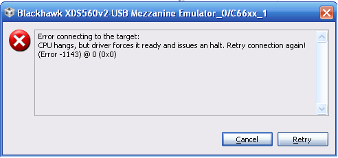

(3)when the code is loaded into core0 and run core0,I check L2 via core1 ,the message is following,is it means core1 is interrupted by IPC ?

    3) when the code is loaded into core0 and run core0,I check L2 via core1 ,the message is following,is it means core1 is interrupted by IPC ?
     sorry but I don't know. but i don't think so.
