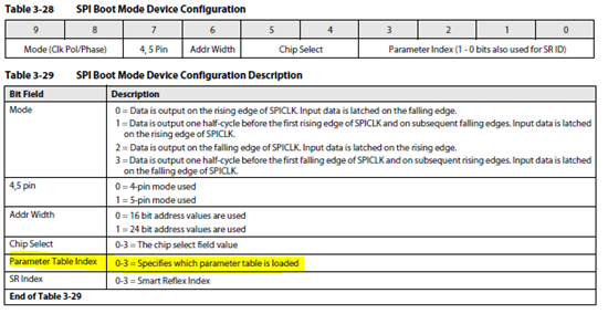

The SPI boot mode for Keystone devices has a bit field "Paramter Table Index" with valid values of 0-3 (table 3-29 of SPRUGY5B).
Where are these 4 parameter tables defined and/or what should this value be set to?

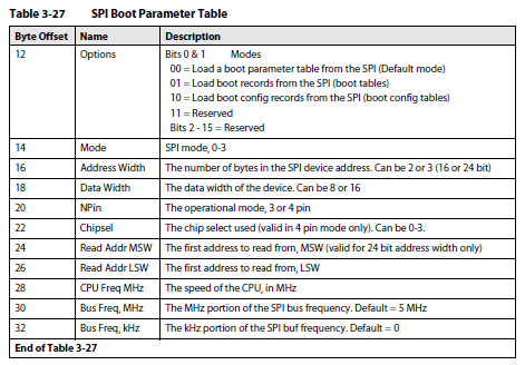

  • Hi Arun, I took a look at the source code, and I'm still unclear how the boot pins affect the SPI boot parameter table. Specifically, what does boot[0-3] "Paramter Table Index" relate to? I couldn't find anywhere in the code where the boot pins are read.
    Possibly, does this directly translate to Options in the SPI boot parameter table?
