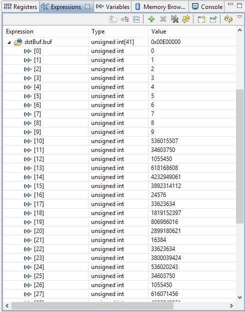

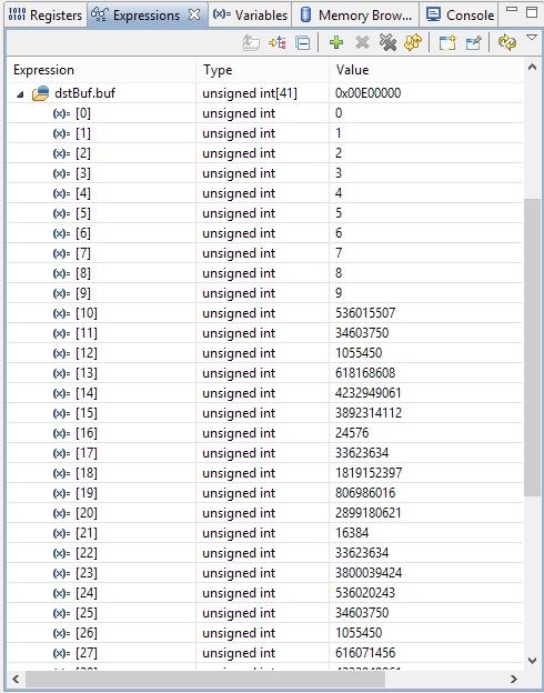

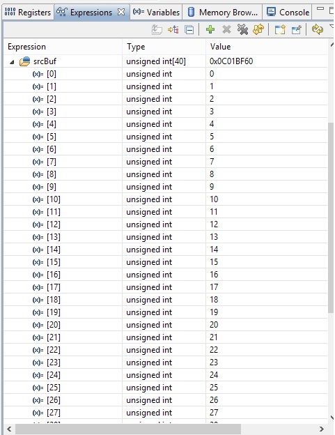

PCIe memory write using EDMA
I tested the code provided by TI to do PCIe communication between two Shannon and it works fine.
Now i want to replace the CPU write to "pcieBase" with the EDMA, so i replaced the loop :
for (i=0; i<PCIE_BUFSIZE_APP; i++)
*((volatile uint32_t *)pcieBase + i) = srcBuf[i];
by a function that uses EDMA to write in pcieBase :
edma_ping_pong_xfer_gbl_region(0, 0,srcBuf,(volatile uint32_t *)pcieBase,PCIE_BUFSIZE_APP*4 + 4);
edma_ping_pong_xfer_gbl_region(EDMA instance number,Channel number ,source address,Destination address,ACNT);
The function is defined below :

printf("EDMA transfer executed \n");
int j;
for(j=0;j<41;j++) {
printf("src[%d]=%d \n",j,Src[j]);
printf("Srcadd[%d]=%d \n",j,&Src[j]);
for(j=0;j<41;j++) {
printf("dst[%d]=%d \n",j,dst[j]);
printf("dstadd[%d]=%d \n",j,&dst[j]);
return 0;
Regards.
