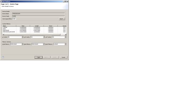

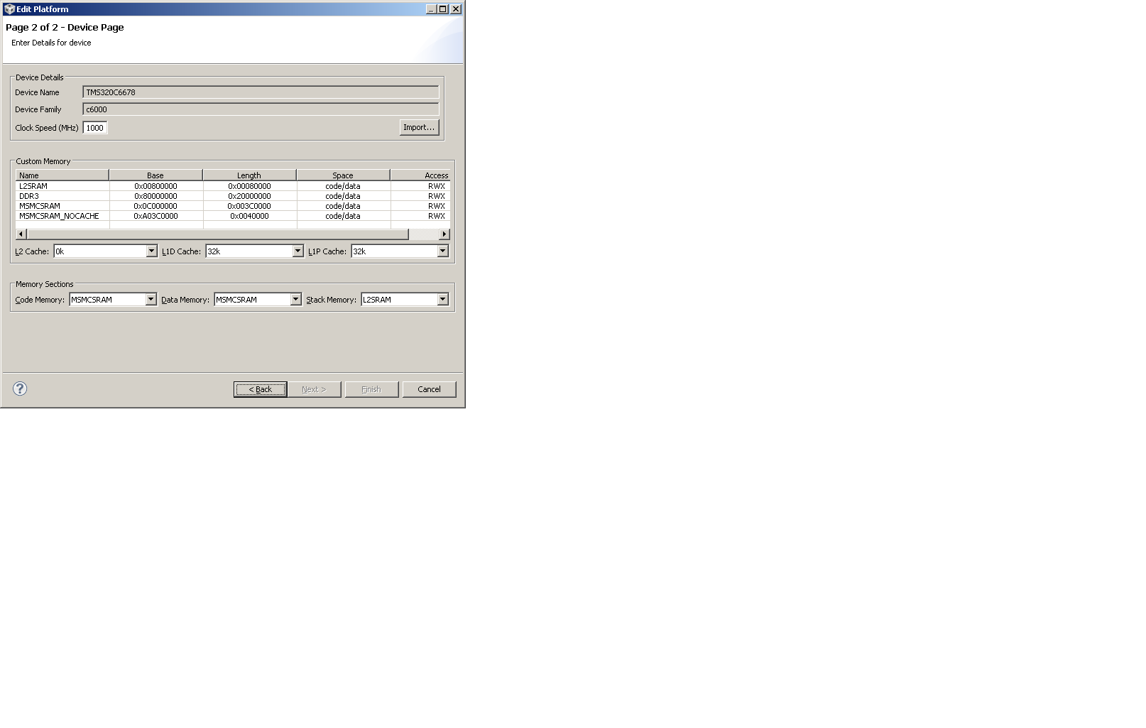

    What does your RTSC Platform config look like? Mine is:
  • Xiaohui,
    Your MAP file was identical to mine (except for the timestamp). I used it, nonetheless, but I didn't get different results. Still:
    [C66xx_0] HANNING#1 = [ 32216 ] cycles
    [C66xx_0] Hello World from thread = 0
    [C66xx_0] Number of threads = 1
    [C66xx_0] HANNING#OMP = [ 32236 ] cycles
    [C66xx_0] OMP TIME = [ 146152 ] cycles
    [C66xx_0] HANNING#2 = [ 32298 ] cycles

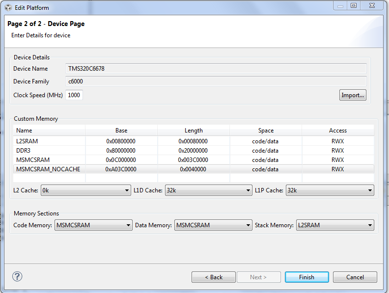

  • 6201.platform.zip

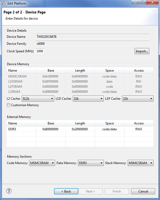

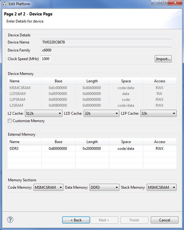

    Actually your platform is quite different from mine.  Your data are allocated in DDR vs mine are in MSMC.  Your stack are in MSMC but mine is in L2 SRAM.  Attached is my platform.

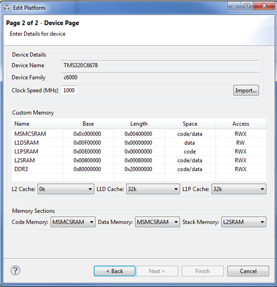

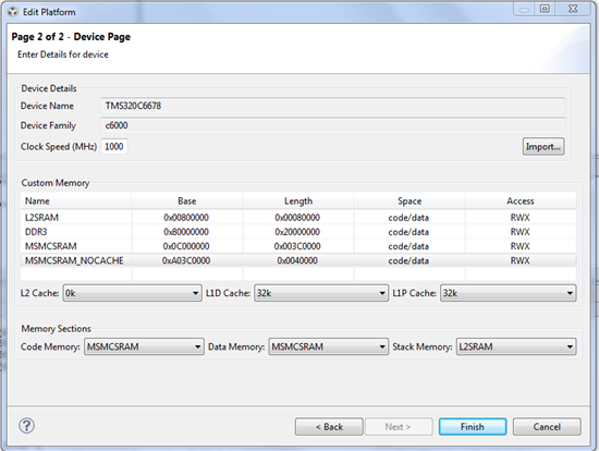

  • Okay, I reconfigured my platform to nearly match yours, except I don't have the MSMCSRAM_NOCACHE section. I still get:
    [C66xx_0] HANNING#1 = [ 32204 ] cycles
    [C66xx_0] HANNING#OMP = [ 32288 ] cycles
    [C66xx_0] HANNING#2 = [ 32262 ] cycles
    My platform settings are attached.
  • Ryan,
    If I remember correctly, your code only compute 2048 samples for Hanning Windowing and each sample only requires one multiply.  Your measured performance indicates it takes more than 15 cycles for each sample. That's way too much.  Could you share your code and .asm from compiler output?
    Xiaohui
  • Ryan,
    Could you deletre L1DSRAM and L1PSRAM two lines from your platform?
    Xiaohui

  • Ryan,
    Your multiplier array starts at 0xa0194500 which is in DDR3.  In my code, it starts at 0x0c0b78a8 which is in MSMC.  This will make huge difference.  I am not sure if the your DDR3 is configured as cachable or non-cachable.  Again that can make huge difference.
    Your memory configuration is:
             name            origin    length      used     unused   attr    fill
      L2SRAM                00800000   00080000  0002bca0  00054360  RWIX
      MSMCSRAM              0c000000   00100000  00039a0a  000c65f6  RWIX
      DDR3                  80000000   20000000  01000000  1f000000  RWIX
      MSMCSRAM_NOCACHE      a0100000   00300000  00096a92  0026956e  RWIX
    My configurations is,
      L2SRAM                00800000   00080000  0002bcc0  00054340  RWIX
      MSMCSRAM              0c000000   003c0000  000bab2a  003054d6  RWIX
      DDR3                  80000000   20000000  00000000  20000000  RWIX
      MSMCSRAM_NOCACHE      a03c0000   00040000  0003996e  00006692  RWIX
    The two configurations is drastic different in the sense that yours uses significant amount of DDR3.  Mine does not use DDR3 at all.
    I think that explains the performance differences we are seeing.
    Xiaohui

  • That didn't help me. How do I load your platform settings? Also, what is the procedure for loading these settings and applying them? Do I need to terminate and reload my target configuration? I've tried that, but didn't produce different results.
    Ryan
  • Ryan,
    You need to unzip and save the platform file I sent to you on your hard drive.  Then open the property of your project and the do the following to add the platform to the repository.
    property->general->RTSC->Add->Select repository from file-system->Browse...
    After adding the desired platform, you can pull down the Platform under the Property window and find and select the platform you need.
    To modify a platform, go to Tools->RTSC Tools->Platform->Edit/New->Browse under Platform Package Repository to go to the directory that has the Platform file then choose the platform under Package Name -> OK.  A window for the platform configuration should pop up to allow you to make any changes.
    Xiaohui
  • Xiaohui,
    Thank you. I was not importing the new platform repository, and I was never setting my project to use a different platform file, so there was no change being made.
    Now my MAP file looks like this:
    MEMORY CONFIGURATION
    NEARRAM 00000001 00007fff 00000000 00007fff RWIX
    RAM 00008000 fffffffe 0000793a ffff86c4 RWIX
    Does this look correct? What does yours look like?
    Ryan
  • Ryan,
    It doesn't look right.  Here is the memory configuration from my .map file.
    Again, this is from the original OpenMP Hello example.  I didn't make any changes.  I would expect the same thing to you.
    Xiaohui

    Could you try deleting DDR from your platform or at least set the length to zero?
    Have you changed to use the save version of IPC that I am using?
    Xiaohui

  • Ryan,
    Could you please check my previous post?  I already sent out the link for OMP 1.02.00.05 which is what I am using.
    Xiaohui
  • Xiaohui,
    Yes, updating to OMP 1.02.00.05 corrected my MAP output file.
    MSMCSRAM 0c000000 003c0000 000b9906 003066fa RWIX
    My benchmark times are much nicer now.

    The OpenMP overhead in this case is around 13000 cycles.  The L2 Cache is enabled in this case.  If you disable L2 Cache, the overhead will down to around 7000 cycles.
