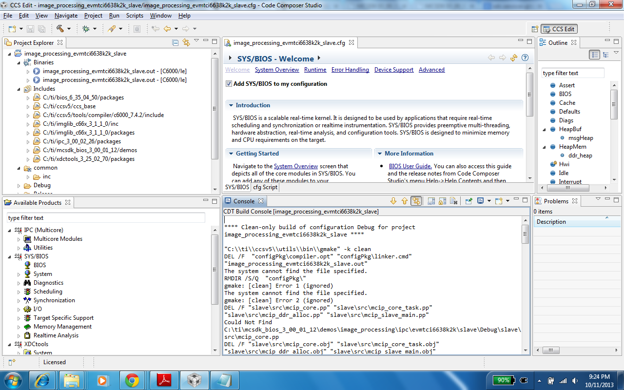

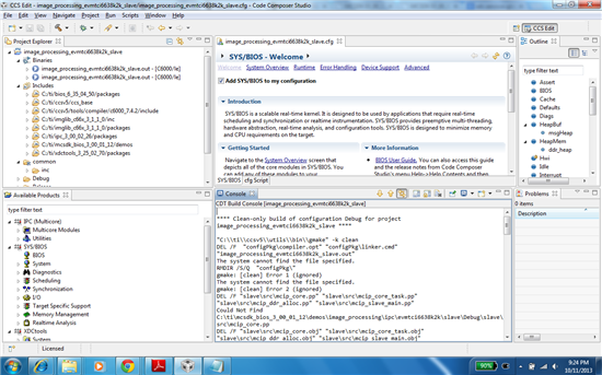

  • Hi Steve Zhang,
    I am not able reproduce the issue reported by you.
    What is the CCS Version you are using? I have checked with CCS 5.4.
    Also i am not able find framework components 03.22.03.09 in my installation directory. (C:/ti/)
    In Project Explorer, not able to fine Framework Components. Refer below screenshot.
    Please find the attached build log for your reference.

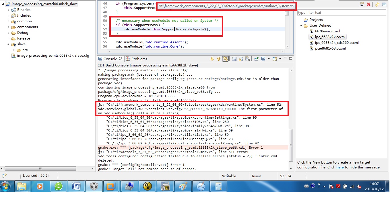

    Another,Please look at the attached files
    From that .the ERRORS called "xdc.cfg.USE_MODULE_PARAMETER_ERROR: The first parameter of an xdc.useModule() call must be a string"   may be produced  on the location ""C:/ti/framework_components_3_22_03_09/fctools/packages/xdc/runtime/System.xs", line 52:"
    When I opened System.xs.liked below:
    /* necessary when useModule not called on System */
    if (this.SupportProxy) {
    xdc.useModule(this.SupportProxy.delegate$);
    So. I thought the error told us  that “this.SupportProxy.delegate$” was not a string .
    so error came. I didn't know how to deal with the issues.
    I didn't know why the error was produced and how to resolve the problem.

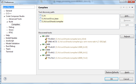

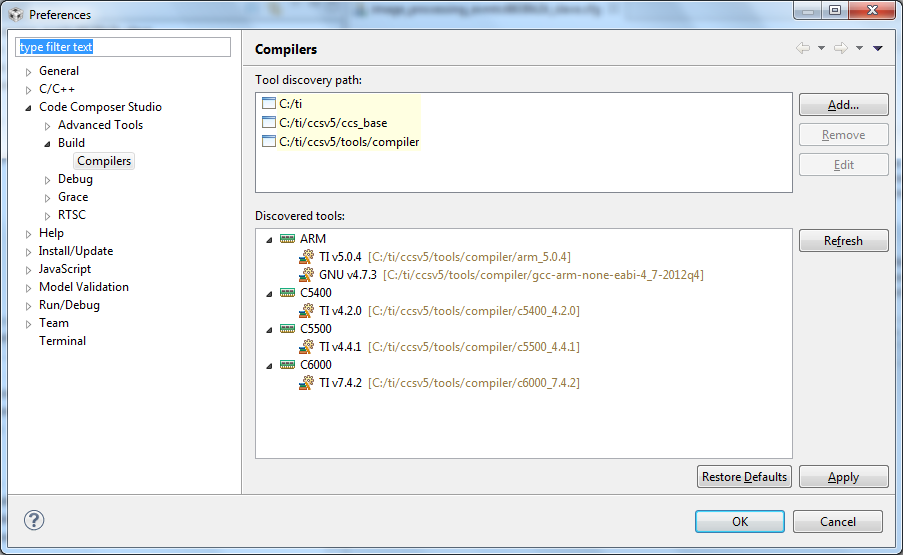

  • Hi Steve,
    Could you please check the compiler version used for build?
    Open Window-> Preferences (I have used TI v7.4.2)
    Could you please share the complete build log for our reference?
    Thanks.
