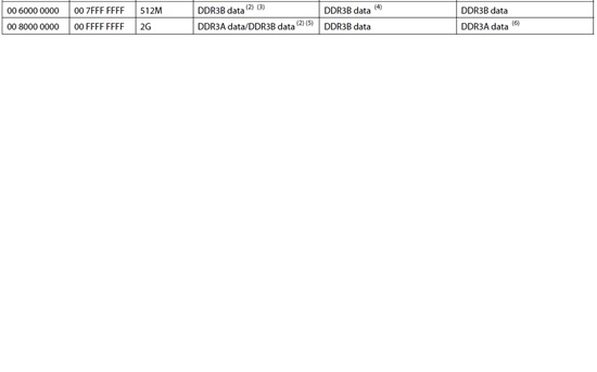

2. From the datasheet, page number 94, SPRS866E November 2013,
Let us first assume the scenario where DDR3A_REMAP_EN pin is '0' which is default settings in the EVM,
The physical memory 00 6000 0000 to 00 7ffff ffff (512M) from ARM view refers to DDR3B data which is same as that of 00 8000 0000 to 00 9ffff ffff as this is aliased of 00 8000 0000 to 00 9ffff ffff (the first 512MB of DDR3B)
The physical memory 00 8000 0000 to 00 FFFF FFFF (2G) from ARM view will be DDR3B data as DDR3A_REMAP_EN pin is '0'.  DSP view will be DDR3B data.
The kernel load address and u-boot CONFIG_SYS_SDRAM_BASE points to 0x80000000
Therefore, in this case, does that mean the EVM uses only DDR3B for both ARM and DSP?

  • Hi, Ram,
    The DRAM size shown in U-boot is DDR3A memory and because of a hardware issue, only half of the memory can be detected in Rev 1.0/1.1 EVM. This issue has been corrected in Rev 2.0 EVM with new silicon.
    The DDR3A_REMAP_EN signal is default to be pull down (page 39) which I believe in software means 1. Hence, for ARM, DDR3B is at 0x6000 0000, and DDR3A at 0x8000 0000.
    As what were said, 0x6000 0000 region is DDR3B for both ARM and DSP. 0x8000 0000 is DDR3B for DSP, but DDR3A for ARM which maps to the 1st 2GB of the 8GB DDR3A memory starting at  0x08 0000 0000. The difference is that when using 32-bit addressing to refer to this 2 GB memory, it does not support IO coherency, while 36-bit addressing to the same area does.
    Hope this clarifies your questions.
    Rex

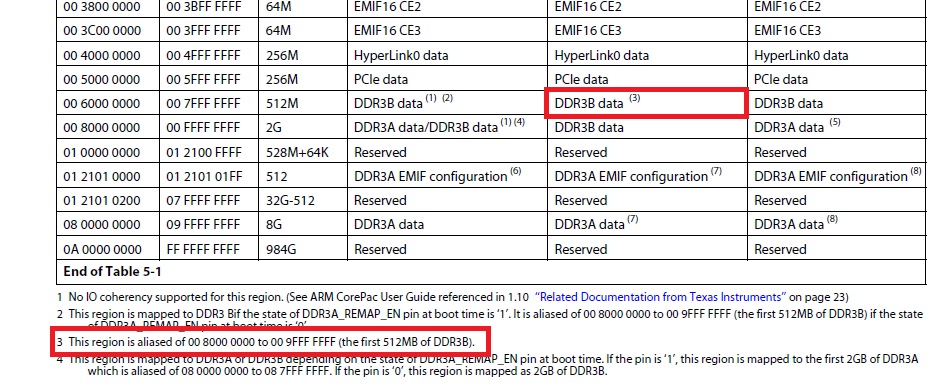

  • Hi,Rex:
    In the datasheet SPRS836A memory map section.
    what does this mean?
    I cannot understand.what does that mean?
    That seems that address range from 0x60000000 to 0x7fffffff is aliased of 0x8000 0000 to
    0x9fff ffff. But what dose that mean?
    what does" aliased" mean?

  • Hi, Steve,
    I think your data sheet may be a bit older than the one I am looking at. Mine is SPRS866E, and yours probably version D, so the note nubers are off. Any way, alias by definition is "
    used to indicate that a named person is also known or more familiar under another specified name." from google and "also called, or otherwise known as" from Merriam-Webster dictionary.
    So, that means the same location can be addressed either using 0x6000 0000 or 0x8000 0000, but it onlly applies to the first 512MB as the address range indicated in the data sheet.
    Rex

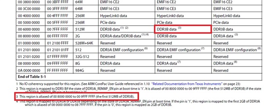

  • Hi Rex,
    Thanks for your clarification.
    There is one question which remains unanswered from you which I had raised, that is what Steve also has been raising in this post. When DDR3A_REMAP_EN pin is zero, the address ranges 0x6000 0000 to 0x7FFF FFFF (512M) from ARM view points to DDR3B data and DSP view also points to DDR3B data which means DDR3A is not used.  Does this mean, DDR3A will not be accessed when DDR3A_REMAP_EN pin is zero?
    3 This region is mapped to DDR3B. It is aliased of 00 8000 0000 to 00 9FFF FFFF (the first 512MB of DDR3B) if the state of DDR3A_REMAP_EN pin at boot time is ‘0’.
    Kindly clarify
    Rams
  • Hi, Ram,
    Ok. So we are clear with DSP view. From ARM's view, if REMAP_EN is 0, then 0x8000 0000 is mapped to 2GB of DDR3B memory. The DDR3A can still be accessed through 0x08 0000 0000. This means 0x8000 0000 is not overlaid onto 0x08 0000 0000 any more. Hope this clarifies it.
    Rex
  • Hi Rex,
    Theoretically, it seems to be right.  You say that 0x8000 0000 is not overlaid onto 0x08 0000 0000 and DDR3A can still be accessed through 0x08 0000 0000.   But u-boot start address is set to 0x8000 0000 and when REMAP_EN is 0, u-boot will always be started in DDR3B and not in DDR3A.  Is this right?
    Rams
  • Hi, Rams,
    I would say yes (theoretically), but we have not tried it and can't remove the theoretically part from the sentence. From your other post, the start address of u-boot is to where the u-boot will relocate itself from MSMC. It should not matter if it is 3A or 3B memory, nor starts from 0x6000 0000 or 0x8000 0000, should it?
    Rex
  • Hi Rex,
    Thanks for your response.  This is exactly we are trying to understand and know the behaviour for our system design.  How do we know that we should set REMAP_EN to 0 or 1?  How does this impact on system memory map if we set it to 0 or 1?.  If we set REMAP_EN to 0 on our custom design, I should be able to predict the impact on our system and the memory map.  And, I would like to do some experiments with EVM to check all these.
    Hope you would appreciate the importance of establishing the theoretical facts.
    Rams

    U-boot using REMAP_EN being 1
    (Note: 0x6000 8000 has different content as 0x8000 0000)
    Is this a proof of 3B vs 3A memory?
    Rex
