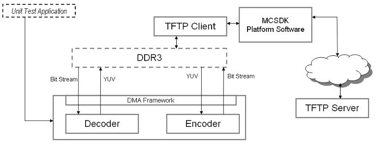

  • Hi Pedro,
    maybe a good match could be our Codecs TFTP demos for Shannon EVM
    http://processors.wiki.ti.com/index.php/MCSDK_VIDEO_2.x_Getting_Started_TFTP_Demo_Guide
    This demo flow is as follows:
    • Platform initialization
    • Network interface initialization
      • Read network configuration file via JTAG file I/O
      • Configure network channel for streaming, and local/remote network endpoints;
    • Read test cases configuration file via JTAG file I/O
    • Loop through all test cases
      • Parse test case configuration file, and set static and dynamic parameters
      • Codec initialization
      • Loop through all frames until end of file reached
        • TFTP Get input file into DDR
        • Process frames (decode or encode)
        • TFTP Put generated bytes to TFTP server
    thank you,
