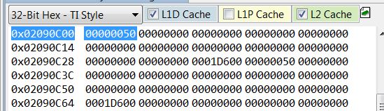

  • I tested the PA_multicoreExample_exampleProject inside PDK 2.1.2.6 on a C6678 EVM. The code is changed as follows in cppi_qmss_mgmt.c:
    #define TX_BUF_SIZE   (((1518+15)/16)*16)
    #define RX_BUF_SIZE   TX_BUF_SIZE
       //dataBufferSize  =   sizeof (pktMatch);
        dataBufferSize  = 1510;
    The NUM_CORES is 4. I didn't see any problem. Attached is a screenshoot at switch registers level, showing 0x28 = 40 decimal packets sent, with 0xec90 bytes = 60560 = 40 * (1510+4).
    Regards, Eric

    0451.multicoreExample.zip
  • Also, add a screenshoot showing number of bytes transmitted for all 80 packets (8 cores x 10 packet/core). Each packet is 1500 bytes.
