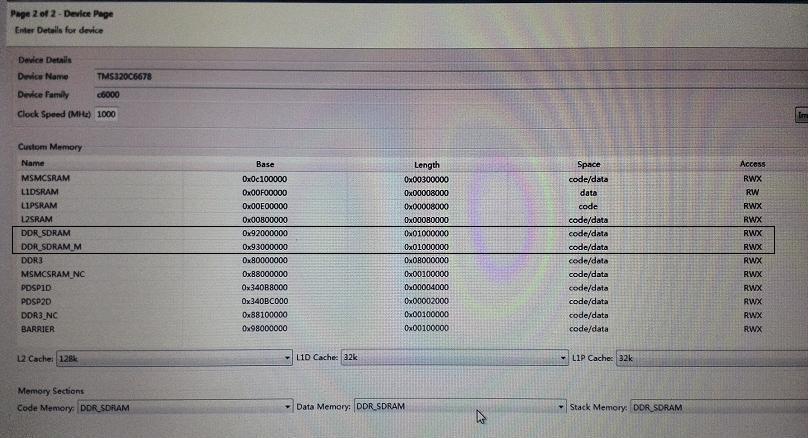

    There are mainly two reasons why I create separate DDR segments for each core.
    1. The memory sections of my project which I added Example_0 to is a little big.  The .text , .stack, .... are bigger than 512k so they can't fit into L2SARM. So I have to put them off chip. At the very first time, I used only one project for both master and slave cores.  But since I put my code,data and stack in DDR which means all cores share one copy of code ,conflicts accured.
    2. Also,  I'm using master-slave model which master does controlling and communication stuff while slave cores only communicate with master core and do algorithm. A little bit like the ti demo image_processing. So I need two projects for a master and a slave.
    Here's my platform for core1. The core0 platform is almost the same except that the
    DDR_SRAM starts at 0x90000000 and DDR_SRAM_M at 0x91000000.
    Sorry the picture is quite blur.
    Did you follow the steps of my last post? Did the same thing happened?
  • Ruijie,
    It is strange that core 1 would try to access part of the rts6600_elf.lib that is located in a portion of memory that it should have no knowledge of. Looking at your map files for both the core 0 build and the core 1 build can you confirm that the .text and .data sections are being linked into the correct memory locations as you would expect? Core 0 should have nothing in its map file that is linked to 0x92000000 - 0x93FFFFFF and core 1 should have nothing in its map file that is linked to 0x90000000 - 0x91FFFFFF.
    If it is possible I would suggest leaving the Stack Memory section in the L2SRAM of each core since each core will need to modify its stack separately. The L2SRAM stack will also be much faster than a DDR stack. This should only present an issue if you load the same code into mulitple cores (cores 1-7 for instance) since you have separate sections for core 0 and core 1.

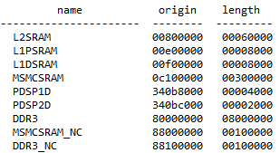

    But I got one more question.When I tried to add my own functions to eo, like func1 and func2. I put them in L2 using CODE_SETION. But when I checked the map files of two projects, the addresses of func1 are the same while the addresses of func2 are not. And addresses of the my_processJob and my_sinkJob and eostart and eostop functions ,each of them are the same in both projects. Only func2 is 0x00832150 on master while 0x00832148 on slave.
    I tried to use the CODE_ALIGN(func, CACHE_L2_LINE) but it didn't change anything. Here, actually, I am not very clear about how to pick up the right number as the align.
    However, I moved the definition of func2 from one .c to receive.c and rebuild, I got the same addresses in both projects of func2.
    I wonder how can I make sure that a function will link to a same address on L2 in two projects?
