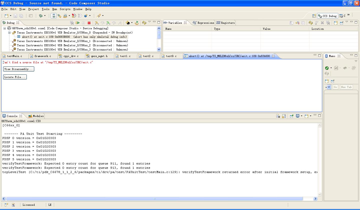

  • The program also print the following error
    (now this error occurs more often):
    verifyTestFramework: Expected 0 entry count for queue 911, found 1 entries
    verifyTestFramework: Expected 0 entry count for queue 913, found 1 entries
    Then the sample exits.

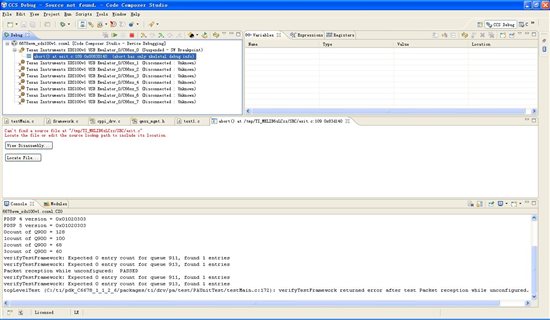

  • hi, Pubesh
    I upload the snapshot.
    The console output is the following:
    [C66xx_0]
    ------- PA Unit Test Starting ---------
    PDSP 0 version = 0x01020303
    PDSP 1 version = 0x01020303
    PDSP 2 version = 0x01020303
    PDSP 3 version = 0x01020303
    PDSP 4 version = 0x01020303
    PDSP 5 version = 0x01020303
    0count of Q900 = 128
    1count of Q900 = 100
    2count of Q900 = 68
    3count of Q900 = 60
    Packet reception while unconfigured: PASSED
    topLevelTest (C:/ti/pdk_C6678_1_1_2_6/packages/ti/drv/pa/test/PAUnitTest/testMain.c:172): verifyTestFramework returned error after test Packet reception while unconfigured. Exiting.

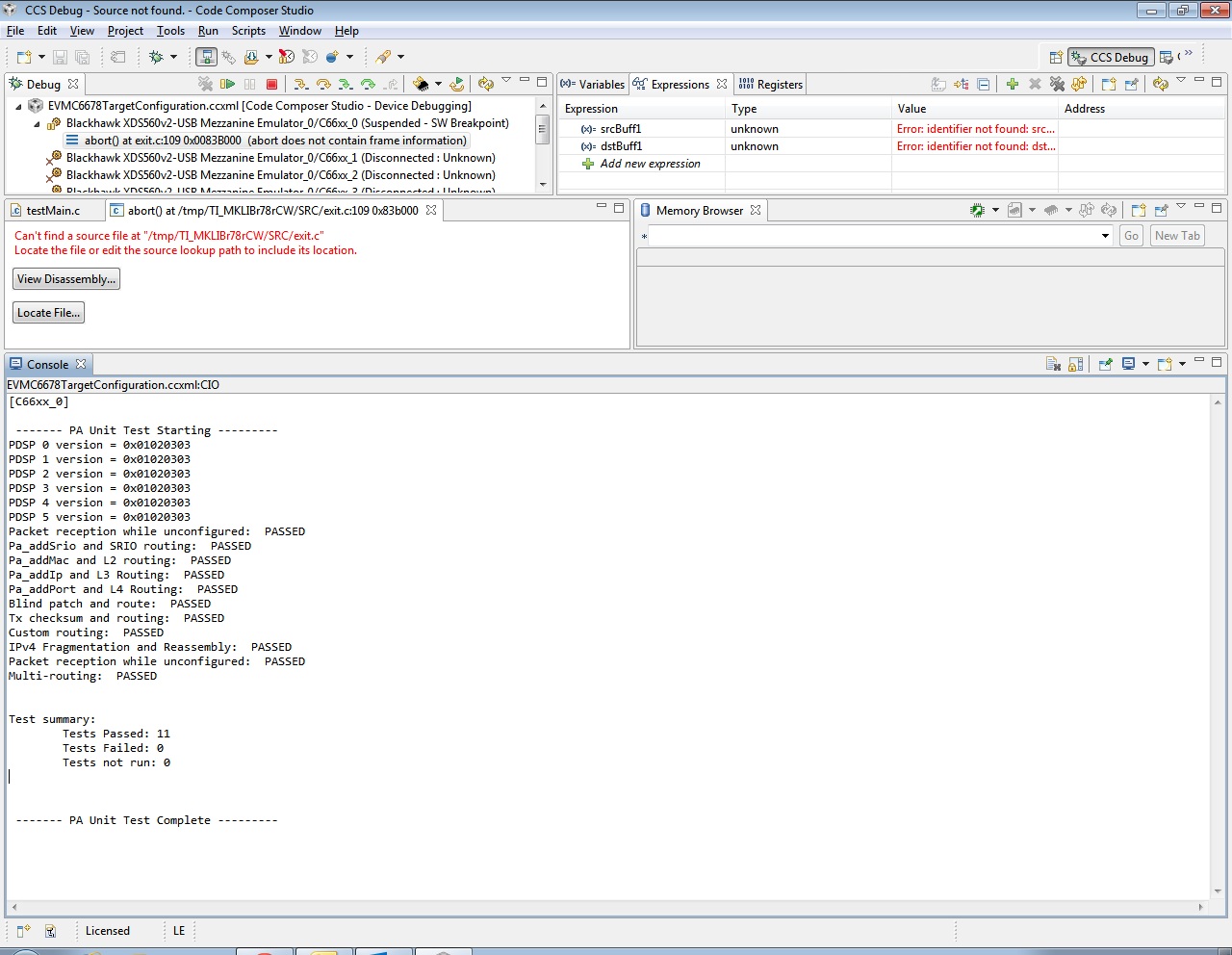

    I have tested PA_unit_test as per the following steps,
    1. Power ON the board, connect the target configuration file.
    2. Select the core0 and connect the target.
    3. Load the PA_unit_test out file and run on the EVMC6678.
    4. Got the test result on CCS console window.
    5. Terminate the target using CCS debug window.
    6. Power OFF the board.
    7. Repeat the steps 1-6 again.
    8. In this test case, I did not find any error on ccs console window. I have done this testing 15 times. There is no issue.
    But in your case, you are getting error message. Please share some more details to reproduce your issue.
    Did you modify anything in this test code? If yes, please share the modification source.

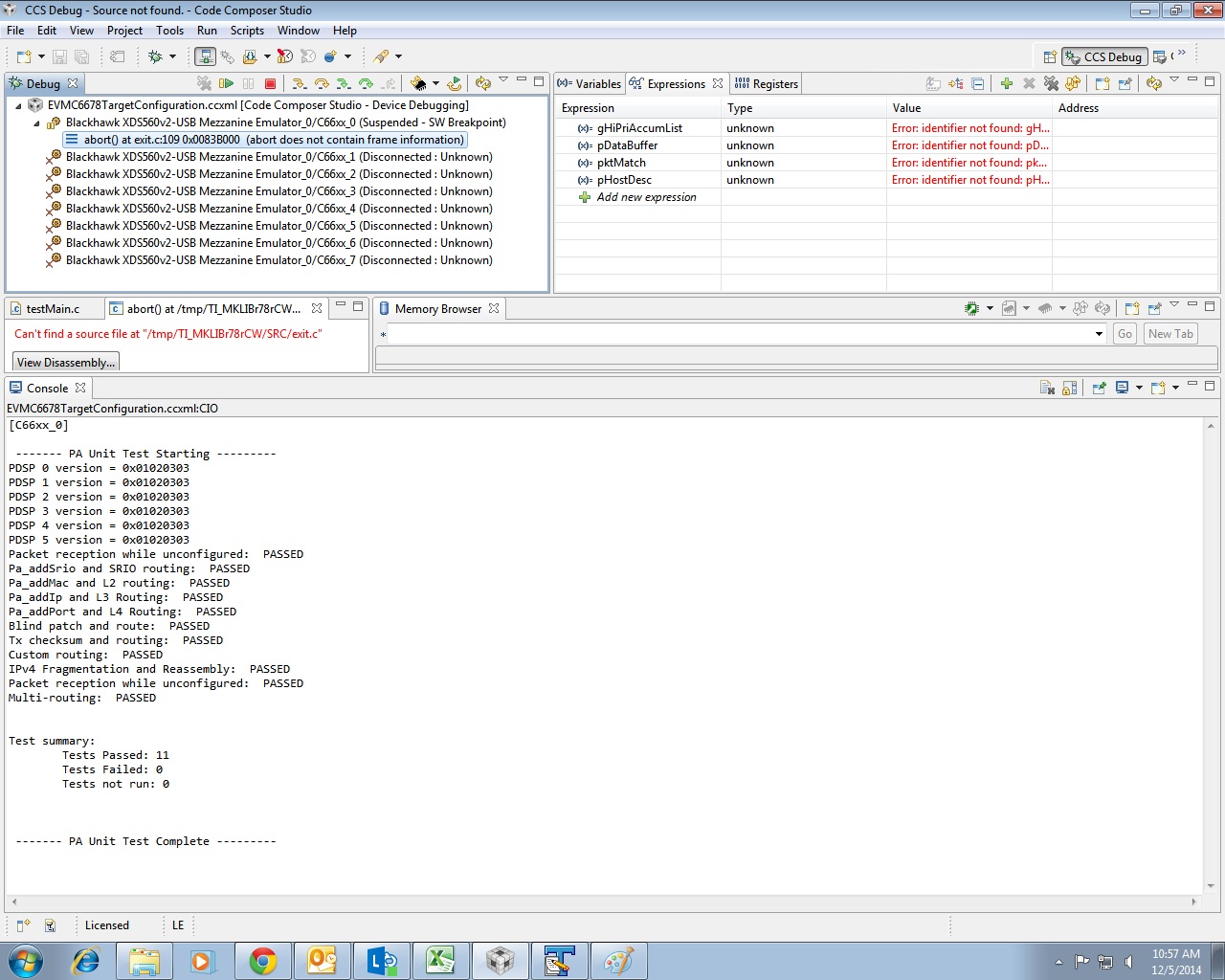

  • hi, Pubesh:
    I tried the original file and rebuild it, the error continues the same.
    (I replace the directory c:\ti\pdk_C6678_1_1_2_6 with the ones
    I backup when the MCSDK has just been installed, that is the original one)
    The following is the snapshot.
    The steps I take is the same as your saying.
    I tried 2 boards with the same result.
