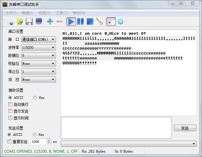

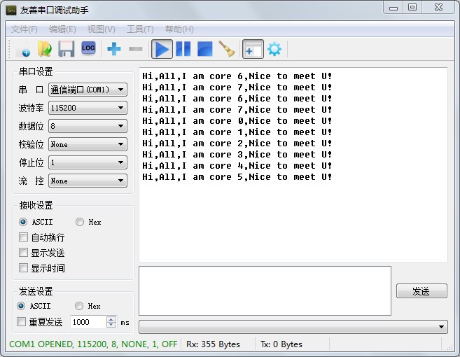

I want to use UART to print different strings from each core to PC.
When in debug mode, The result as I expected  like  this:
but when i burn the image to SPI nor flash, It print like this:
I think I used the semaphore in a wrong way,please help,this is my source code:
