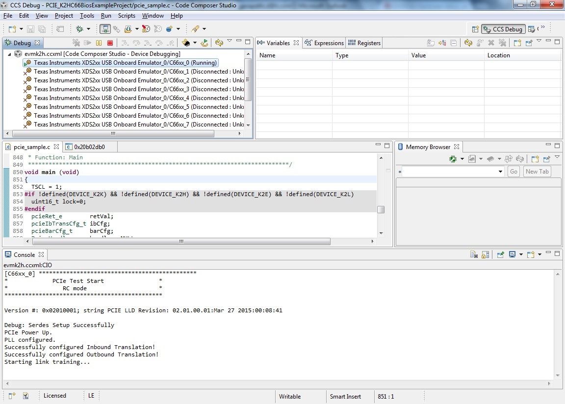

    Try to debug the example code step by step. I have tested the example on EVMK2H, it is properly printing the debug log in CCS console window. See my below screen shot:
    Have you set the EVM boot mode as No-Boot mode? Refer below wiki to check the EVM boot mode
  • Thanks now I am able to see printing in debug console for PCIe example. But printing stops at "Starting link training...". When I observe ltssm state. it shows state 0x02 which is POLL_ACTIVE. state is not changing what ca cause that
