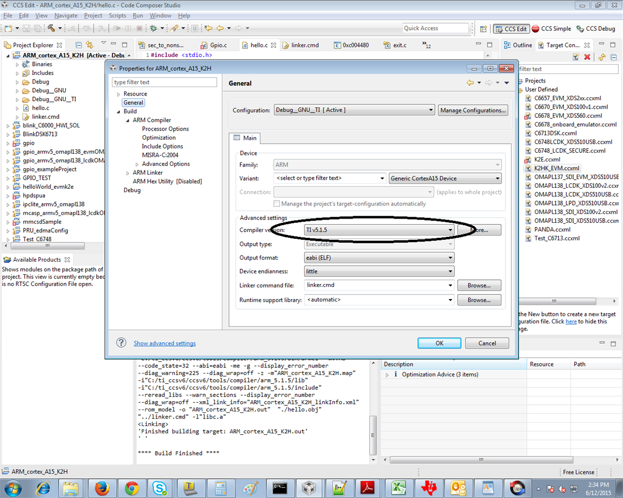

I'm using CCSv6 and unsuccessfully trying to get a bare metal 'Hello World' example up and running on an A15 core of my EVMK2H.
Does anyone have a complete example project they can share or a guide they can point me at?

    Please do the following steps to run the ARM bare code on K2H.
    1) Create a sample hello world application with "Generic cortexA15 device" in CCSv6
    2) Add the attached linker command file (*.cmd)
    3) Please ensure that you have selected appropriate TI ARM compiler for building (Attached for reference)
    4) Build the project and you would get *.out file.

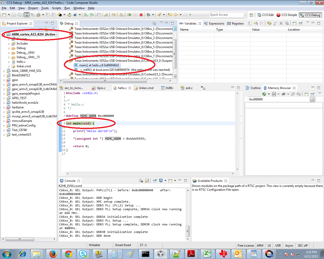

    5) Set boot mode to "DSP no boot"
    6) Select "DSP core 0 and provide the K2H gel file.
    7) Connect target with DSP core0 and DDR/PLL/PSC modules get initialized.
    8) Now select ARM core 0 and connect it.
    9) Finally load and run the ARM app on ARM core0.
    LINKER command file:
    -heap  0x800
    -stack 0x1000
    MEMORY
    L2SRAM: o = 0x00800000  l = 0x00900000
    MSMCSRAM: o = 0x0c000000 l = 0x0C600000
    /* External DDR3, upto 2GB per core */
    DDR3: o = 0x80000000  l = 0x01000000 } SECTIONS { .text > DDR3 .cinit > DDR3 .const > DDR3 .switch > DDR3 .data > DDR3 .stack > DDR3 GROUP { .neardata .rodata .bss } > DDR3 .far > DDR3 .fardata > DDR3 .cio > DDR3 .sysmem > DDR3 }
