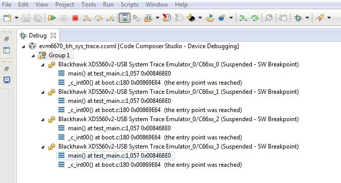

I am working on 6670 Multi core FFT test project using EVM6670LE. I can run the project successfully in synchronous mode by grouping all the cores as shown below(CCSv6). Same code is loaded into the four cores. I am trying to understand the execution order of the cores. Core 0 is responsible for enabling power for FFT co-processor. So Core 0 should run first in order for the other cores to execute the FFTC code.
1. So can someone explain me the sequence in which the cores run when I run the entire group ?
2. Is there a way to configure the order of execution of cores ?

  • Hi Hari,
    If the target supports synchronous execution (C6670 does) and the cores are in a fixed group, then the all cores should execute at the same time. Otherwise, synchronous execution cannot be guaranteed and same with the order of which cores are executed (cannot be controlled). If you wish to ensure the first core executes before the others, then you should exclude that core from the group and execute it first, then execute the group.

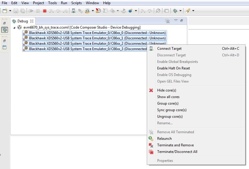

  • Hi Ki,
    I see two different options for grouping the cores 1. Group core(s) and 2. Sync group core(s) on CCSv6.1. I don't see Sync group core(s) option in the above wiki.
    Above ccsv5 wiki link says a 'Fixed Group' is preferred to ensure synchronous execution of the group. Here Group core(s) option is used to create a fixed group.
    So on CCSV6 what is the difference between 1. Group core(s) and 2. Sync group core(s) ? Is there a wiki for CCSv6 as well ?
    Here is the screencapture.
