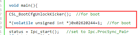

    void main(){
    CSL_BootCfgUnlockKicker();  //for boot
    *(volatile unsigned int *)0x02620244=1;  //for boot
    status = Ipc_start();   //set to Ipc.ProcSync_Pair

    The problem is when I remove those code lines for boot, the application works fine. But when I add them , core0 is stuck at Semaphore_pend(sem0) where seems it never receive any Notification from core1. Hence, core1 would trap in Semaphore_pend(sem1).  You maybe need to know that I test that using online emulation since boot can't work. and there isn't any error or exception happened.
    So, I wander if the IPC interrupt used by the boot procedure interferes the Notify_sendEvent() ?

  • Hi Raja,
    But I don't think I used the Notify event to boot slave cores, and I do call Notify APIs after Ipc_start()/ipc_attach() is called. You can see that Notify_registerevent() is just called behind Ipc_tstart() and while(ipc_attach(x)!=0) . while Notify_sendevent() is called in a task which run after the BIOS is charging.
    So, I didn't quite understand your words.  those code line bellow is surely using the IPC registers and CSL functions.
    could you explain me more to figure that out?
    Thank you!
