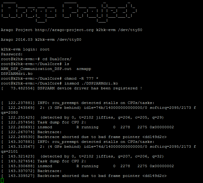

I want to achieve Dual Core Communication between DSP Core0 and ARM Core0. In ARM side, run Linux OS while DSP side run No OS program. Dual core communication finished by configure interrupts each side. In ARM side, I need configure interrupts through Linux driver. In my driver, I have configured the GIC-400 registers for IPCGR0, which is 4# SPI event. The configuration of GIC register is according to the NO OS IPC demo downloaded from TI forum, which is work fine.
I have compiler my driver by using cross compiler within Linux kernel 4.1.8 come with mcsdk3.1.4.7 successfully, however, when I install driver by using command
insmod ./DSP2ARMdri.ko
Linux console is can't work anymore, it seem that Linux system halted. I can't find the reason of this.
Is my driver wrong, or the configuration of GIC-400 is wrong in Linux driver.

  • Hi Xiaop,
    Can you use printk's in your module to see where the hang happens at?
    It might be risky to reprogram the GIC during runtime, as Linux is using it.
    Mike

    I have test my driver in steps below:
    (1) Insmod DSP2ARMdri.ko
    (2)run dsp demo by using mpmcl
    (3)run linux user space program named armapp
    However, when I implement the 1st step, it can't work anymore. The linux console is halt, and can't excute any
    command anymore, just print some unexceptly message. Here is the print mesage when I insmod the driver.
    It it clear the driver has finish the initialization process, however then it is wrong, which I can't figure it out. I want
    to know whether I can solve the problem. I think there is a risky between my driver and the cofiguration within IPC
    components.
    Do you have any advice to archieve the communication between ARM and DSP in this way?
