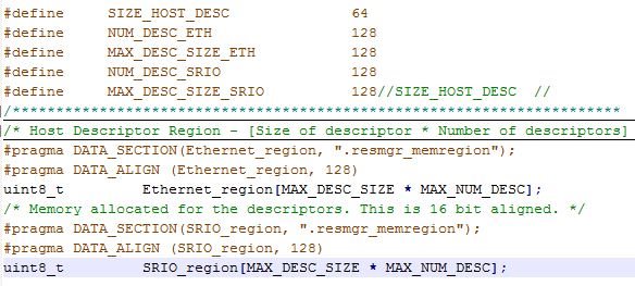

  • Dear Garrett
    I could build the project, I modified the project as below such that SRIO and NDK work in parallel:
    1) I created a new "*.cfg" file.
    2)I created two memory region for ethernet and SRIO.
    3)I changed the queue numbers,
    4) I changed the event ID and Interrupt number for SRIO.
    5) SRIO and NDK created in two tasks.

    I spend a lot of time and try hard but unfortunately, when I ran the program SRIO and NDK didn't work at the same time.
    Q1:
    Is it possible I E_Mail my project for you and you see the code?
    Please help me.
    Best Regards

  • Hi
    Yes, SRIO works but NDK failed for the ping. I checked a special address in DSP memory that FPGA wrote in that address via SRIO DIO and I saw the data received correctly.
    The sequense of calling my functions(in the main()) are as below:
    1) Qmss_Cppi_PA_Init();
    2) SRIO (enable_srio();, SrioDevice_init();, Srio_init(); and clearSrioStatusErrors(); )
    3) GPIO_INIT();
    4) setupSRIOAppConfig((Qmss_MemRegion)Qmss_MemRegion_MEMORY_REGION1); .
    In stage one I declared and init Qmss, Cppi, and PA.
    In stage two I only modify " SrioDevice_init() " function that I can communicate to FPGA.
    In stage three I init GPIO that I think it didn't have the effect on the problem.
    In stage four I called " setupSRIOAppConfig() ". I called this function with a separate memory region " Qmss_MemRegion_MEMORY_REGION1" from Ethernet memory region "Qmss_MemRegion_MEMORY_REGION0" .
    I should mention that I called SRIO and DIO in two tasks.

  • dariush,
    >>I should mentioned that I called SRIO and DIO in two tasks.
    You probably meant SRIO and NDK in two tasks. Are these tasks with the same priority? Can you try to set the SRIO to higher priority to see if it still behaves the same - SRIO works but NDK fails for the ping. This will help determine if any conflict with Cppi_initDescriptor in the use case.

  • dariush,
    You may try to trace where the NDK/CPSW functionality fails by comparing the NDK/SRIO integrated project and the project commenting out SRIO. Also, look into wireshark trace to see if the NDK fails in tx or rx path. By adding nimu_eth.c file into your project may help debug.
    In the last update of the thread - e2e.ti.com/.../291465, it appears to use same QMSS memory region helps get SRIO+NDK working.
    Garrett
