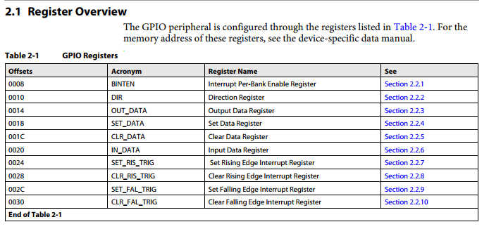

I will try to in and out using GPIO 2, 3.
And i will control gpio using mmap() because sysfs is too slow ( I want output frequency to 5MHz).
I know below.
#define GPIO_BASE		0x0260BF00
#define GPIO_START_ADD	0x0260BF00
#define GPIO_END_ADD	0x0260BFFF
static int dev_fd;
int main(void) {
	dev_fd = open("/dev/mem", O_RDWR | O_SYNC);
	if (dev_fd < 0) {
		printf("oepn(/dev/mem) failed.\n");
		return 0;
	unsigned int *map_base = (unsigned int *)mmap(NULL, 0xFF, PROT_READ | PROT_WRITE, MAP_SHARED, dev_fd, GPIO_BASE);
	if (map_base == MAP_FAILED) {
		perror("Map failed;\n");
		return -1;
	return 0;
The result is invalid argument.
What is problem?
