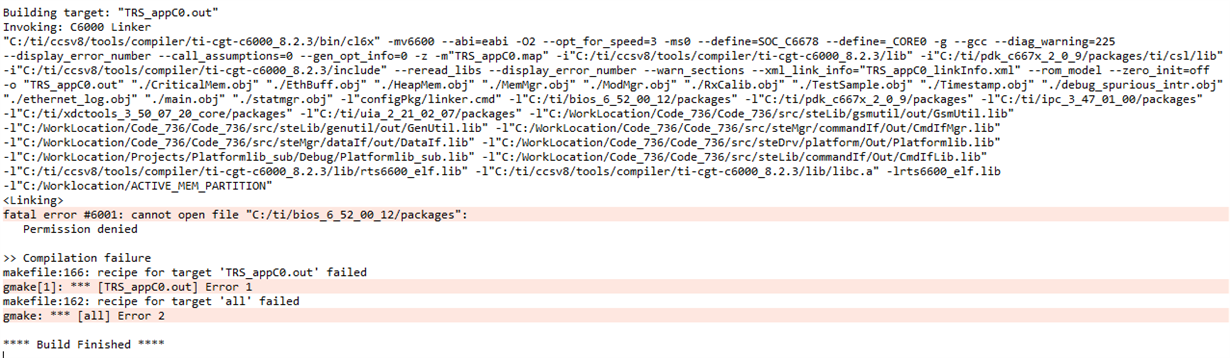

when i build the project, it throws lot of errors on low level library. please find the error snapshots.
am i missing any file path here? this is my include directory.

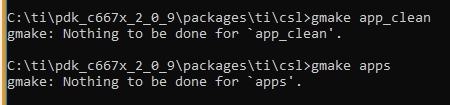

    I am following the document and will be able run the run the command to build the csl library. but its not building it seems.
    getting following messages.
    and also find the make file commands available in the makefile inside csl directory and it does not contain valid make command it seems.

  • Bala,
    This seems to an issue with out documentation. The document only seems to indicate how to build CSL examples and not the library itself.
    There are no apps supported inside the CSL folder for C667x devices. The CSL usage is demonstrated in the LLD and the platform library and the IBL bootloader code. So the target app and app_clean doesn`t apply to this device
    To build the CSL libraries for C667x, please follow the steps below:
    cd pdk_c66x_x_x_xx\packages
    pdksetupenv.bat
    //If you have installed SDK in custom directory other than default C:\ti then follow the developers guide for alternate options.
    To clean build CSL library use:
    gmake csl
    gmake csl_clean
    The build will take a while but the clean build step is required only if you have modified the CSL library code and want to update the library. The package comes with these libraries pre-built in the folder: pdk_c667x_x_x_x\packages\ti\csl\lib\C667x\c66\release

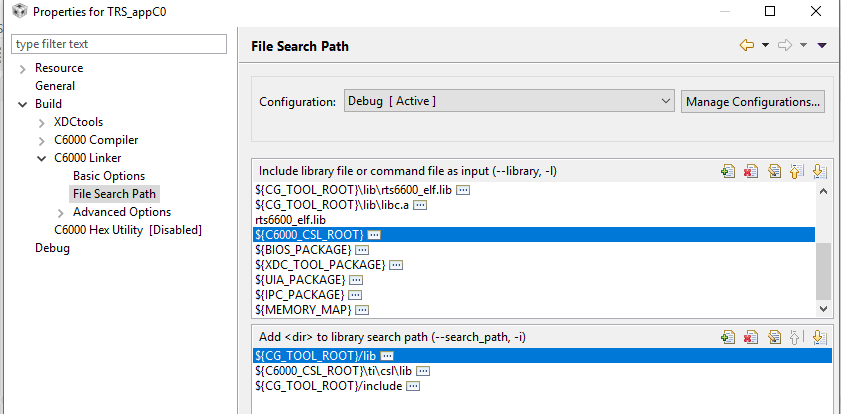

    Thank you, Now i will be able to build the library project. but when i build the core project i am ending with the following errors.
    fatal error #6001: cannot open file "C:/ti/pdk_c667x_2_0_9/packages":  Permission denied
    i have tried changing the file permission as suggested in the forum, but it does not get this solved.
    Linker file search path:
    expansion of my macros as follows

    as per the forum thread below, its been asked to passing -l option to linker is not correct.
    Please look at the my library are passing with option -l. how do we remove the option -l ?
    Bala

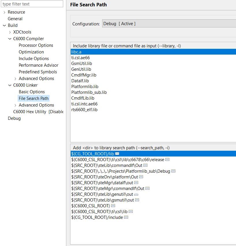

  • Bala,
    the option "-l " for the compiler is used to link the libraries and --search_path or -L is used to add the search path for the library for examples if the library bios_elf.lib is located at C:\ti\bios_6_52_00_12 then you need to add
    bios_elf.lib in the CCS Linker settings -l and the path to the library in --search_path option. In your screenshot you have several paths that you have added to -l option, remove that and move them to --serach_path option and this should resolve your issue.

  • HI Rahul,
    As you suggested I have kept all my library in Linker and added search path for all the library as follows.
    But still I am getting the following errors while building the project. do you have any suggestion for this errors?
