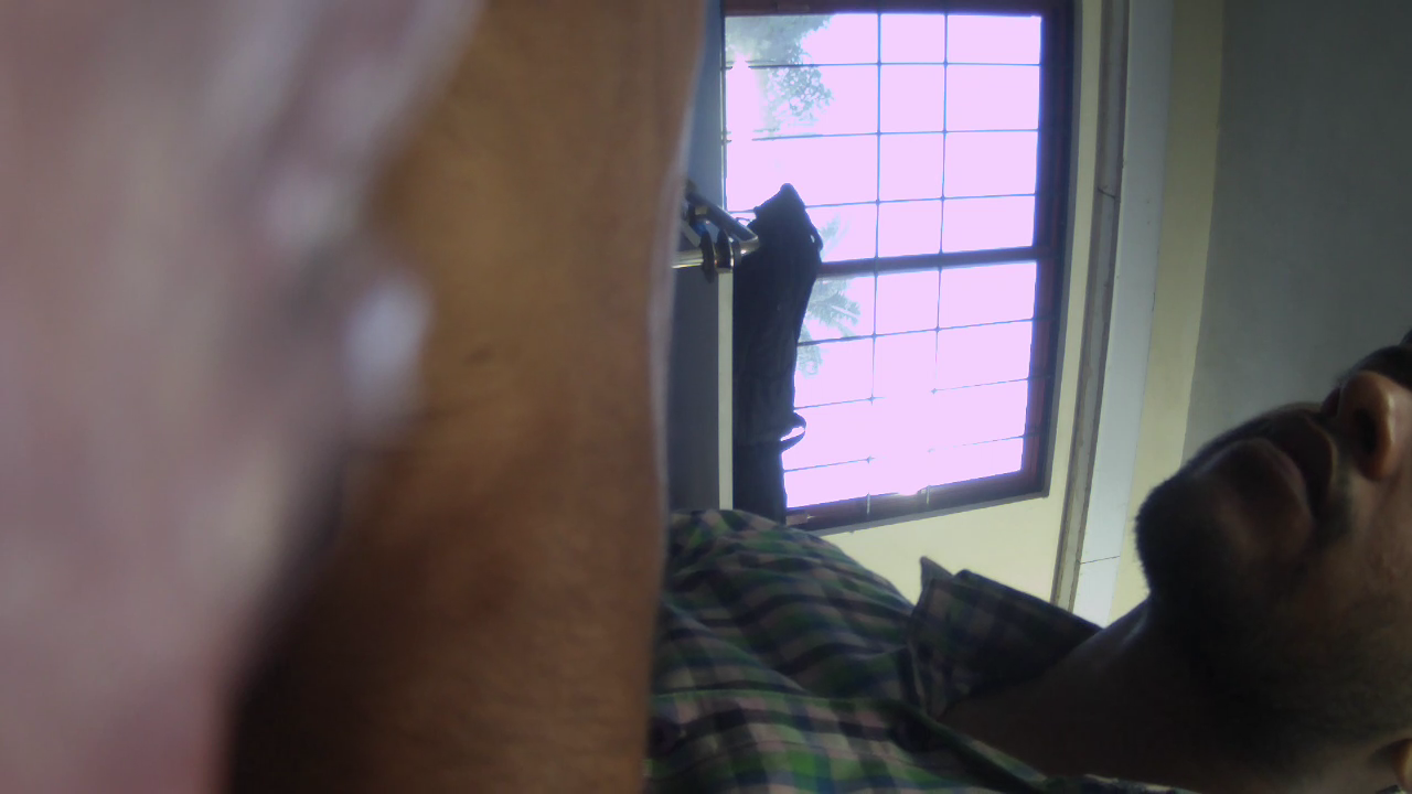

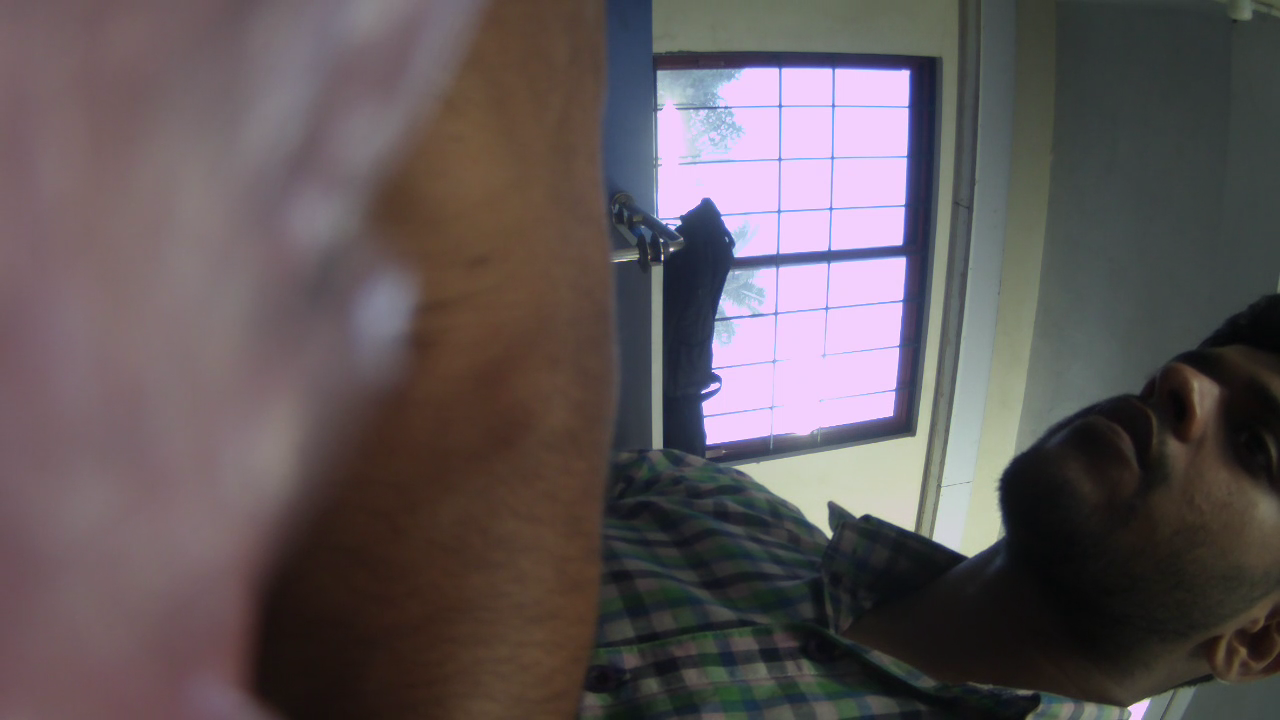

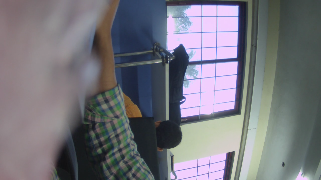

    I tried as you suggested I gave the options as..
    GBEStrength= 64; GCEStrength= 256;
        LBEStrength= 4096; LCEStrength= 4096;And got the result like this
    After disabling this is the result
    This after changing the parameters to
        LBEStrength= 8192; LCEStrength= 4096;
    The result is this
    So I am not able to find any notable difference here.
    Sorry for the late reply!.
    GLBCE can't recover pixels which are already saturated from sensor. From the image you have shared the region in window are already saturated. Can you please try with different AE metering modes ? Also make sure  AE target is not too high.
