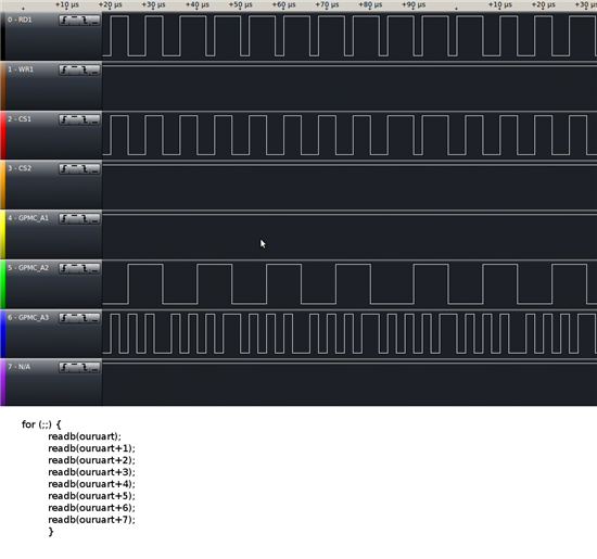

It seems there is something wrong with the address lines.  A loop through all the address values causes the A2:A3 lines to flicker up and down as they should, but A1 to stick high.

  • I have attached an image of the logic output of the OMAP's GPMC_[A1:A3] pins along with the code I used, in the hope that it may help.

    Meanwhile can you send me the waveform with the following lines?
    GPMC_A1, A2, A3, RD1, WR1, CS1, CS2.
    Also have you access the address from u-boot and saw the waveform?
    Renjith
  • Andrew,
    Got it. CONFIG1 should be 0x0 instead of 0x1000, as you are configuring the interface to 16-bit instead of 8-bit. Try this and let me know.
  • Hi Renjith,

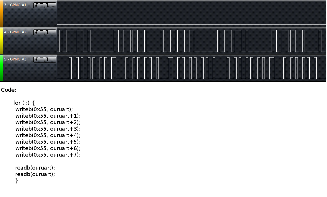

    Here are the captures you requested.  Thanks very much for taking a look.

  • Hi Andrew,
    If you look at the A2 and A3 lines waveform there is a difference. The period of A2 in the first image(during read) is totally inverted in case of write. Ideally it should be same as address access is same.
    So, could you please send me the complete code including in the macro definitions of readb() and writeb() and the pre-processor output generated(-E option)? If this is not a macro, could you please send me the assembly code generated (-S option)?
