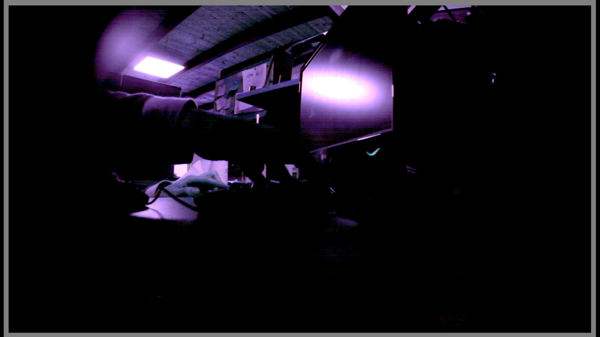

  • Hi Mingda,
    I have created a chain like you advised, using Camera link -> ISP Link, enabling M2M procesing
    The ISP link outputs two 1080p streams to a merge link which leads to encoder and RTSP stream.
    and I have a few questions regarding this:
    1) It seems that the Bayer pattern is reversed when using this method, what is the reason for this? In addition, in the first stream, the image is surrounded by a gray frame and also occasional green blinking on the sides (see attached image).
    2) I wish to create a use case where one stream is sent directly to memory and the other is processed in on-the-fly mode in IPIPE, how can this be implemented using Link API?
    3) Is there a way to perform RAW -> YUV conversion on the stream that is sent directly to memory, without using IPIPE?
    ISP cannot introduce this green pixels, it might be coming from the sensor itself. can you check if this is some blanking data from the sensor? We could crop this blanking data from the sensor in either ipipeif or ipipe.
    ISP can work either in M2M mode or in OTF mode, so it is not possible to have two streams, one on the fly and other in M2M mode
    it is always possible to bypass all the modules in the IPIPE, so you could get RAW to YUV. But please note that IPIPE does most of the conversion from RAW to YUV. So you will have to enable some minimal modules.
    Brijesh
  • Hi Brijesh,
    Thanks for your reply.
    Regarding the image artifacts: When using a regular chain with OTF processing (Camera -> Encoder -> RTSP) I see no such effects (gray frame, green blinking). It only happens when I enable M2M mode, and even then the second stream did not show such artifacts. The green artifacts are similar to what can be seen when a resizer overflow happens. Could this be an issue with DDR bandwidth?
    Regarding the data path, I wish to use the following use case:
    Parallel sensor -> ISP on the fly -> camera link -> encoder -> rtsp stream
    MIPI sensor -> straight to memory -> (RAW to YUV?) -> encoder -> rtsp stream
    But the problem here is that encoder can only accept YUV data, and ISP is already used by the first path.
    Is it possible to do RAW -> YUV conversion on the second stream while the first stream is using the ISP already in OTF mode?
    If so I'd like to know how this can be done.
    Eli
  • It looks like cropping is enabled somewhere, but it is not when M2M mode. Here could you compare register settings of IPIPEIF, IPIPE and Resizer for both the cases? Also what do you mean by second stream?
    No, it is not possible to use ISP in both the mode. I think in this case, you should ISP in m2m mode only and convert raw data from both the streams into yuv using ISP in m2m mode.
    Regards,Brijesh
  • Right now, the second stream comes out from the camera link, as defined in low-power tri-streaming usecase, except I have both streams at 1080p. They enter a merge link and then encoder and RTSP stream.
    Regarding the ISP issue, can the ISP process two separate streams simultaneously using M2M mode?
    If so, does that apply to all modules or only RAW -> YUV ?
    To clarify, this is the scenario I am referring to
    MIPI -> DDR -> ISP(RAW->YUV) ---------------------> Merge
         |---------------->Encoder---->RTSP
    CPI -> DDR -> ISP (IPIPE + H3A + RAW->YUV) -> Merge
  • I think the second stream is down scaled version of the first stream itself. so if the first stream does not have any artifacts, second stream also should not have any artifacts. I think there is something else which is introducing these artifacts.
    H3A output is not possible since h3a output comes from the ISIF and ISIF will be used in CPI->DDR path.
    Regards,Brijesh
  • Yes, right now the second stream is a clone of the first one, but the artifacts appear only on the first stream and only when using M2M mode. What can be causing this?
    If I understand you correctly, aside from H3A, the ISP can process streams from both sensors using M2M?
    Is this supported in MCFW?
