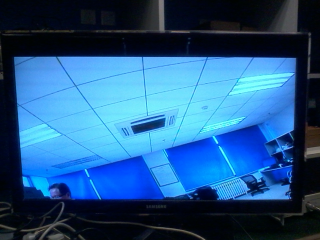

tvp5147 capture error on emv8148 iocard using DVRRDK3.0, is anyone help me ?
Other Parts Discussed in Thread: TVP5147
I'm using DVRRDK3.0 on evm8148 iocard.
I can capture data from tvp5147.
But it have two problems:
1.on the top ,it lost data.
2.it only have even,  no odd.
logs:

VcapVdis_start------calling------Vsys_create---------
 317: MCFW  : CPU Revision [ES2.1] !!!
 317: MCFW  : Detected [UNKNOWN] Board !!!
 317: MCFW  : Base Board Revision [REV A] !!!
 Device_tvp5147GetChipId OK !-------------------- ChipId = 20807
Vcap_configVideoDecoder------calling------Device_tvp5147Control------IOCTL_DEVICE_VIDEO_DECODER_GET_VIDEO_STATUS---
Device_tvp5147GetVideoStatus-----regValue[0]==126----
Device_tvp5147GetVideoStatus-----regValue[1]==160----
Device_tvp5147GetVideoStatus-----regValue[2]==130----
Vcap_configVideoDecoder------done--------Device_tvp5147Control------IOCTL_DEVICE_VIDEO_DECODER_GET_VIDEO_STATUS---
Vcap_configVideoDecoder-------------videoStatus.isVideoDetect----==1-----
 VCAP: TVP5158-2 (0x5c): Detected video (720x288@50Hz, 1) !!!
Vcap_configVideoDecoder------calling------Device_tvp5147Control------IOCTL_DEVICE_VIDEO_DECODER_SET_VIDEO_MODE---
Vcap_configVideoDecoder------done----------Device_tvp5147Control------IOCTL_DEVICE_VIDEO_DECODER_SET_VIDEO_MODE---
Vcap_configVideoDecoder------calling------Device_tvp5147Control---2---IOCTL_DEVICE_VIDEO_DECODER_GET_VIDEO_STATUS---
Vcap_configVideoDecoder------done--------Device_tvp5147Control---2---IOCTL_DEVICE_VIDEO_DECODER_GET_VIDEO_STATUS---
 VCAP: TVP5147-1 (0x5c): Detected video (720x288@50Hz, 1) !!!
Vcap_configVideoDecoder  -----------------  Done !
init dei prm
init display param
create capture
 [m3vpss ]  454376: CAPTURE: Create in progress !!!
 [m3vpss ] pInstPrm->videoDecoderId = 1024
 [m3vpss ] pInstPrm->vipInstId = 2
 [m3vpss ] pVipCreateArgs->videoIfMode = 0
 [m3vpss ]  454409: CAPTURE: VIP1 PortA capture mode is [16-bit, Non-mux Discrete Sync - ACTVID_VBLK] !!!  sdfasd
 [m3vpss ] streamId  == 0
 [m3vpss ] pOutInfo->dataFormat  == 1
 [m3vpss ] pOutInfo->memType  == 0
 [m3vpss ] param->videoIfMode = 1
 [m3vpss ] param->inDataFormat = 6
 [m3vpss ] param->videoCaptureMode = 5
 [m3vpss ] param->periodicCallbackEnable = 1
 [m3vpss ] param->numCh = 1
 [m3vpss ] param->numStream = 1
 [m3vpss ] param->inScanFormat = 0
 [m3vpss ] param->muxModeStartChId = 0
 [m3vpss ] param->scParams.inWidth = 168
 [m3vpss ] param->scParams.inHeight = f0
 [m3vpss ] param->scParams.outWidth = 168
 [m3vpss ] param->scParams.outHeight = f0
 [m3vpss ] param->outStreamInfo[0].maxOutHeight = 4
 [m3vpss ] param->outStreamInfo[0].maxOutWidth = 0
 [m3vpss ] param->outStreamInfo[0].dataFormat = 1
 [m3vpss ] param->outStreamInfo[0].memType = 0
 [m3vpss ] param->outStreamInfo[0].numLinesInSubFrame = 0
 [m3vpss ] param->outStreamInfo[0].pitch[0] = 5c0
 [m3vpss ] param->outStreamInfo[0].subFrameModeEnable = 0
 [m3vpss ] param->outStreamInfo[0].scEnable = 0
 [m3vpss ] param->cscConfig->bypass = 0
 [m3vpss ] param->cscConfig->mode = 8d6383e9
 [m3vpss ] createStatus = 8e709930
 [m3vpss ] createStatus1 = 8e709930
 [m3vpss ] pObj->state != VPS_CAPT_STATE_IDLE = 0
 [m3vpss ] createStatus3 = 8e709930
 [m3vpss ] createArgs->scParams.inCropCfg.cropHeight  = 240
 [m3vpss ] createArgs->scParams.inCropCfg.cropWidth  = 360
 [m3vpss ] pObj->semStopDone= 8ec4ebe8
 [m3vpss ] pObj->semStopDone = 8ec4ebe8
 [m3vpss ] pObj->createArgs.numCh	 = 1
 [m3vpss ] single channel modes	pObj->createArgs.videoCaptureMode = 5
 [m3vpss ] single channel modes	pObj->createArgs.inDataFormat  = 6
 [m3vpss ] pObj->createArgs.outStreamInfo[streamId].dataFormat  = 1
 [m3vpss ] pObj->resAllocParams.inSrc = 1
 [m3vpss ] Vcore_vipResAllocPath  status = 0
 [m3vpss ] Vps_captAllocPath   status = 0
 [m3vpss ] Vps_captCreateChObj   status = 0
 [m3vpss ] status a= 0
 [m3vpss ] status b= 0
 [m3vpss ] status c= 0
 [m3vpss ] status d= 0
 [m3vpss ] status = 0
 [m3vpss ] pObj = 8e4ff978
 [m3vpss ] pInst->captureVipHandle = 8f0cb908
 [m3vpss ] CaptureLink_drvIsDataFormatTiled(&pDrvObj->createArgs, streamId)  0

somes important code:
for(vipInstId=0; vipInstId<1; vipInstId++)
pCaptureInstPrm = &capturePrm.vipInst[vipInstId];
pCaptureInstPrm->vipInstId = SYSTEM_CAPTURE_INST_VIP1_PORTA;//(SYSTEM_CAPTURE_INST_VIP0_PORTA+vipInstId)%SYSTEM_CAPTURE_INST_MAX;
pCaptureInstPrm->videoDecoderId = SYSTEM_DEVICE_VID_DEC_TVP5147_DRV;
pCaptureInstPrm->inDataFormat = SYSTEM_DF_YUV422P;
pCaptureInstPrm->standard = SYSTEM_STD_576I;
pCaptureInstPrm->numOutput = 1;
pCaptureOutPrm = &pCaptureInstPrm->outParams[0];
pCaptureOutPrm->dataFormat = SYSTEM_DF_YUV422I_YUYV;
pCaptureOutPrm->scEnable = FALSE;
pCaptureOutPrm->scOutWidth = 0;
pCaptureOutPrm->scOutHeight = 0;
pCaptureOutPrm->outQueId = 0;
if (pInstPrm->videoDecoderId == FVID2_VPS_VID_DEC_TVP5147_DRV)
Vps_printf("pVipCreateArgs->videoIfMode = %d\n",pVipCreateArgs->videoIfMode);
inScanFormat = FVID2_SF_INTERLACED;
if(pObj->createArgs.enableSdCrop)
pInst->maxWidth = 704;
else
pInst->maxWidth = 720;
if (pObj->isPalMode)
pInst->maxHeight = 288;
else
pInst->maxHeight = 240;
inWidth = pInst->maxWidth;
inHeight = pInst->maxHeight;
pVipCreateArgs->videoIfMode = VPS_CAPT_VIDEO_IF_MODE_16BIT;
pVipCreateArgs->numCh = 1;
pVipCreateArgs->videoCaptureMode =
VPS_CAPT_VIDEO_CAPTURE_MODE_SINGLE_CH_NON_MUX_DISCRETE_SYNC_ACTVID_VBLK;
