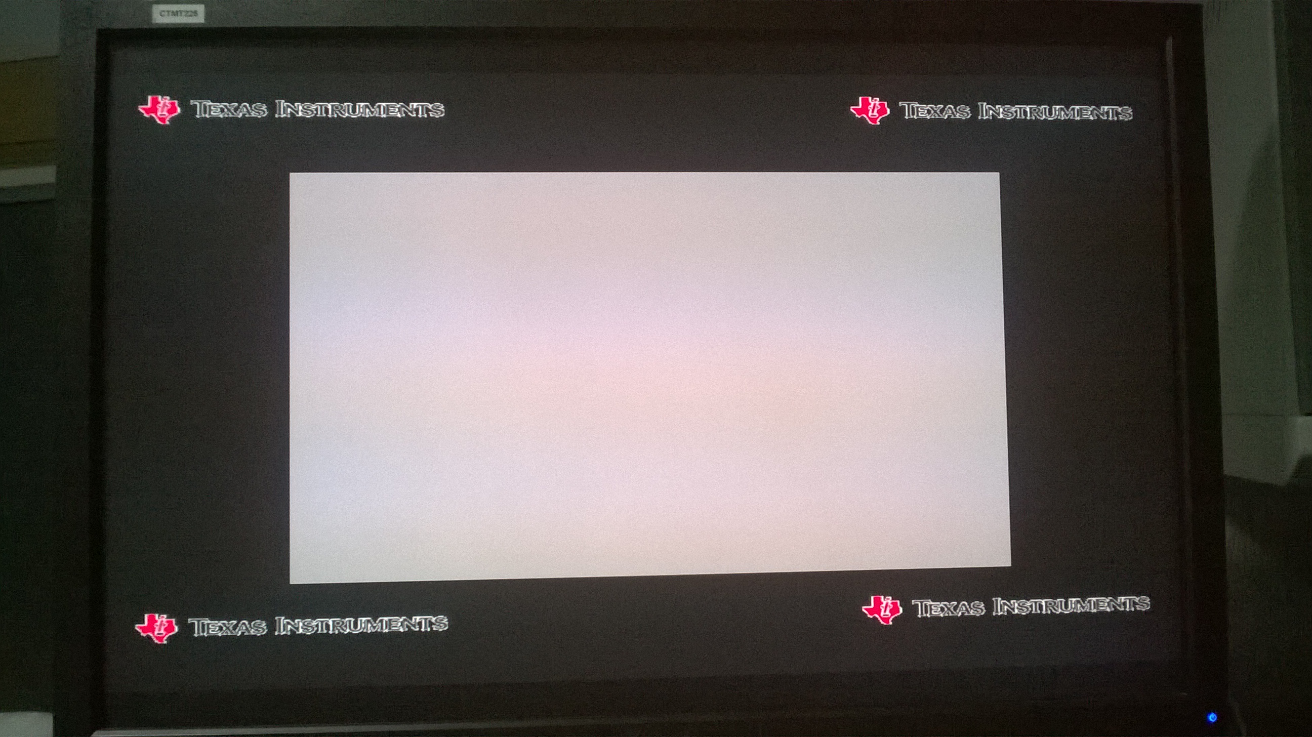

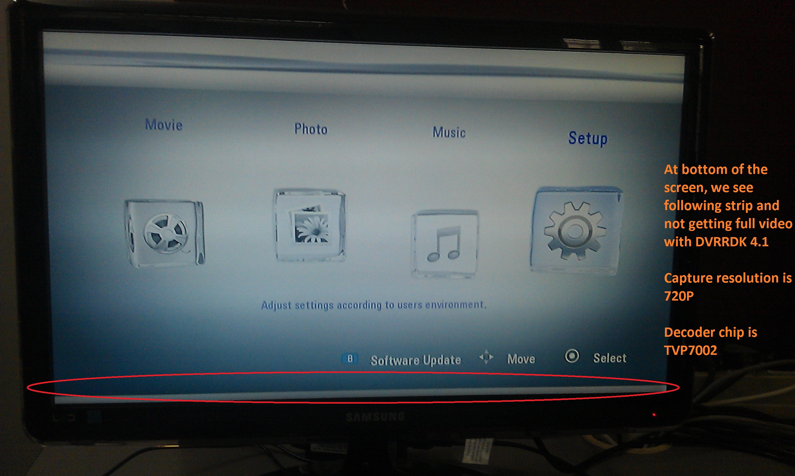

We are doing 720P capture->display using TVP7002 in DVRRDK 4.1. We are able to do successful capture->display but on bottom of display we are getting a gray strip as shown in below snapshot.
We double-checked the TVP7002 register configuration and observed no issue with it. When we configure TVP7002 in same way and use SDK then we are not getting any gray strip and getting full video on display.
Anybody faced such issue, please provide some inputs.

  • Hi Badari,
    Please refer the attached detailed core statistics. Here we are doing two simultaneous capture one from another decoder and one from TVP7002. Only on captured video from TVP7002 we see only 705 lines.

  • The Video Input Parser (VIP capture) is receiving only 705 height frame. This is an issue with capture source. Can you confirm you are not seeing the bottom strip if you display the capture output from VIP 0  which shows correct height.
  • Hi Badari,
    Correct, we are not observing gray strip if we capture from VIP0 using HDMI decoder. We are configuring both VIP instances in same way. Also, with same hardware if we use SDK then we are able to do capture-display without any strip on display for same resolution.

  • It is not issue with VIP configuration. Short frames are being received from external video source (705 height) . I am not familiar with SDK  but if possible try printing the capture driver advanced statistics and check the height reported by driver when using SDK.
  • Hi Badri,
    We use v4l2 driver to configure TVP7002. So via auto-detection functionality of driver we are seeing prints that detected resolution is 1280x720.
    In another experiment, we ran capture-display using SDK and took TVP7002 register dump and saved into a file. And again with RDK we took TVP7002 register dump and saved into a file. In both cases there is NO difference in register dump of TVP7002, it means decoder is getting configured in same way.
    I remember correctly that earlier also we observed this issue with RDK 3.5 but at that time changing highlighted line with 720 it got resolve,
    File  :  DVRRDK_03.50.00.05/dvr_rdk/mcfw/src_bios6/links_m3vpss/capture/captureLink_drv.c
     case FVID2_STD_720P_60:
         inScanFormat = FVID2_SF_PROGRESSIVE;
             pInst->maxWidth = 1280;
             pInst->maxHeight = 748;              // Changed to 720
    Ronak
  • Can you dump the 32-bit value at physical address
    0x48105530
    0x48105a30
    when running SDK and RDK.You can use mem_rdwr.out to read physical address.
  • Hi Badri,
    Sorry for delayed response,
    RDK: We ran our custom demo (captures two channels of 720P, one from SII9135 and another from TVP7002 and video blending on top of it)
    0x48105530: 050002D0
    0x48105a30: 050002C1
    SDK: We ran saLoopBackFbdev application.
    0x48105a30: 00000000
    Ronak
  • For RDK the VIP1 frame capture height is shown as 0x2C1 indicating incoming height is 705.(VIP0 height is shown correctly as 0x2D0 (720))
    For SDK VIP 1 is not being used for capture so no meaningful comparison is possible.
  • Hi Badri,
    On SDK too we observed the same issue.So, it's not specific to RDK/SDK and you are correct it's related to source.
    The real issue was in configuration of TVP7002. Following line needs to be changed in v4l2 driver of TVP7002. Now, we are able to see complete video.
    { TVP7002_VBLK_F_0_DURATION, 0x2D, TVP7002_WRITE },
    to
    { TVP7002_VBLK_F_0_DURATION, 0x1E, TVP7002_WRITE },
    Thanks a lot for your help.

  • Hi Badri,
    I am working on Mistral TI DM8148 EVM with DVR RDK4.1.
    In MCFW demos changed one of the application to perform single channel capture and display.
    As per logs it not at all capturing frames.Please help me..
    Please find the attached log file,tvp7002 configuration file and my application files.
    ./init.sh
    ./load.sh
    ./tvp_7002.sh(720p60)
    ./run.sh
    I am using i2cset utility to write to TVP7002 registers.
    Thanks in advance.
    Kiran S Patil

    Serial: 8250/16550 driver, 4 ports, IRQ sharing enabled
    omap_uart.0: ttyO0 at MMIO 0x48020000 (irq = 72) is a OMAP UART0
    console [ttyO0] enabled, bootconsole disabled
    omap_uart.1: ttyO1 at MMIO 0x48022000 (irq = 73) is a OMAP UART1
    omap_uart.2: ttyO2 at MMIO 0x48024000 (irq = 74) is a OMAP UART2
    omap_uart.3: ttyO3 at MMIO 0x481a6000 (irq = 44) is a OMAP UART3
    omap_uart.4: ttyO4 at MMIO 0x481a8000 (irq = 45) is a OMAP UART4
    omap_uart.5: ttyO5 at MMIO 0x481aa000 (irq = 46) is a OMAP UART5
    brd: module loaded
    loop: module loaded
    ahci probe: devid name is ahci
    ahci CAP register dump =0x6726ff80
    Modified ahci CAP register dump =0x6f26ff80
    ahci ahci.0: forcing PORTS_IMPL to 0x1
    ahci: SSS flag set, parallel bus scan disabled
    ahci ahci.0: AHCI 0001.0300 32 slots 1 ports 3 Gbps 0x1 impl platform mode
    ahci ahci.0: flags: ncq sntf stag pm led clo only pmp pio slum part ccc apst
    scsi0 : ahci_platform
    ata1: SATA max UDMA/133 mmio [mem 0x4a140000-0x4a150fff] port 0x100 irq 16
    omap2-nand driver initializing
    ONFI param page 0 valid
    ONFI flash detected
    NAND device: Maf ID: 0x2c, Chip ID: 0xca (Micron, NAND 256MiB 3,3V 16-bit)
     erasesize: 0x20000, writesize: 2048, oobsize: 64
    omap2-nand: detected x16 NAND flash
    Creating 7 MTD partitions on "omap2-nand.0":
    0x000000000000-0x000000020000 : "U-Boot-min"
    0x000000020000-0x000000260000 : "U-Boot"
    0x000000260000-0x000000280000 : "U-Boot Env"
    0x000000280000-0x000000580000 : "U-Boot Logo"
    0x000000580000-0x0000009c0000 : "Kernel"
    0x0000009c0000-0x00000d1e0000 : "File System"
    0x00000d1e0000-0x000010000000 : "Reserved"
    davinci_mdio davinci_mdio.0: davinci mdio revision 1.6
    davinci_mdio davinci_mdio.0: detected phy mask fffffffc
    davinci_mdio.0: probed
    davinci_mdio davinci_mdio.0: phy[0]: device 0:00, driver unknown
    davinci_mdio davinci_mdio.0: phy[1]: device 0:01, driver unknown
    CAN device driver interface
    CAN bus driver for Bosch D_CAN controller 1.0
    d_can d_can: d_can device registered (irq=52, irq_obj=53)
    usbcore: registered new interface driver cdc_ether
    usbcore: registered new interface driver dm9601
    usbcore: registered new interface driver cdc_acm
    cdc_acm: v0.26:USB Abstract Control Model driver for USB modems and ISDN adapters
    Initializing USB Mass Storage driver...
    usbcore: registered new interface driver usb-storage
    USB Mass Storage support registered.
    mice: PS/2 mouse device common for all mice
    ata1: SATA link down (SStatus 0 SControl 300)
    qt602240_ts 1-004a: Family ID: 128 Variant ID: 1 Version: 22 Build: 171
    qt602240_ts 1-004a: Matrix X Size: 18 Matrix Y Size: 12 Object Num: 17
    input: AT42QT602240/ATMXT224 Touchscreen as /devices/platform/omap/omap_i2c.1/i2c-1/1-004a/input/input0
    omap_rtc omap_rtc: rtc core: registered omap_rtc as rtc0
    i2c /dev entries driver
    Linux video capture interface: v2.00
    usbcore: registered new interface driver uvcvideo
    USB Video Class driver (v1.0.0)
    OMAP Watchdog Timer Rev 0x00: initial timeout 60 sec
    nss_aes_mod_init: loading NSS AES driver
    nss-aes nss-aes: NSS AES hw accel rev: 3.2 (context 0 @0x41140000)
    nss-aes nss-aes: NSS AES hw accel rev: 3.2 (context 1 @0x41141000)
    nss-aes nss-aes: NSS AES hw accel rev: 3.2 (context 2 @0x411a0000)
    nss-aes nss-aes: NSS AES hw accel rev: 3.2 (context 3 @0x411a1000)
    nss_aes_probe: probe() done
    nss_des_mod_init: loading NSS DES driver
    nss-des nss-des: NSS DES hw accel rev: 2.2 (context 0 @0x41160000)
    nss-des nss-des: NSS DES hw accel rev: 2.2 (context 1 @0x41161000)
    nss_des_probe: probe() done
    nss_sham_mod_init: loading NSS SHA/MD5 driver
    nss-sham nss-sham: NSS SHA/MD5 hw accel rev: 4.03 (context 0 @0x41100000)
    nss-sham nss-sham: NSS SHA/MD5 hw accel rev: 4.03 (context 1 @0x41101000)
    nss-sham nss-sham: NSS SHA/MD5 hw accel rev: 4.03 (context 2 @0x411c0000)
    nss-sham nss-sham: NSS SHA/MD5 hw accel rev: 4.03 (context 3 @0x411c1000)
    nss_sham_probe: probe() done
    usbcore: registered new interface driver usbhid
    usbhid: USB HID core driver
    notify_init : notify drivercreated  for  remote proc id 2 at physical Address 0xbfd00000
    usbcore: registered new interface driver snd-usb-audio
    Registered tvp5158 audio codec
    *** Forcing SW CTS!
    asoc: tvp5158-hifi <-> davinci-mcasp.0 mapping ok
    asoc: tlv320aic3x-hifi <-> davinci-mcasp.2 mapping ok
    asoc: HDMI-DAI-CODEC <-> hdmi-dai mapping ok
    ALSA device list:
      #0: TI81XX SOUND0
      #1: TI81XX SOUND1
    TCP cubic registered
    NET: Registered protocol family 17
    can: controller area network core (rev 20090105 abi 8)
    NET: Registered protocol family 29
    can: raw protocol (rev 20090105)
    can: broadcast manager protocol (rev 20090105 t)
    Registering the dns_resolver key type
    VFP support v0.3: implementor 41 architecture 3 part 30 variant c rev 3
    omap_voltage_late_init: Voltage driver support not added
    Power Management for TI81XX.
    Detected MACID=0:18:32:61:57:18
    omap_rtc omap_rtc: setting system clock to 2000-01-01 00:00:00 UTC (946684800)
    mmc0: host does not support reading read-only switch. assuming write-enable.
    mmc0: new high speed SDHC card at address e624
    mmcblk0: mmc0:e624 SD08G 7.40 GiB
     mmcblk0: p1 p2
    CPSW phy found : id is : 0x4dd074
    Sending DHCP requests .
    PHY: 0:01 - Link is Up - 0/Half
    PHY: 0:01 - Link is Down
    PHY: 0:00 - Link is Up - 1000/Full
    ., OK
    IP-Config: Got DHCP answer from 192.168.1.5, my address is 192.168.1.235
    IP-Config: Complete:
         device=eth0, addr=192.168.1.235, mask=255.255.255.0, gw=192.168.1.1,
         host=192.168.1.235, domain=, nis-domain=(none),
         bootserver=192.168.1.5, rootserver=192.168.1.5, rootpath=
    VFS: Mounted root (nfs filesystem) on device 0:15.
    devtmpfs: mounted
    Freeing init memory: 232K
    INIT: version 2.88 booting
     Mounting /dev/shm              :  Mounting /dev/pts          :  Mounting other filesystems :  Mounting /dev/sda1              : mount: mounting /dev/sda1 on /media/sda1 failed: No such file or directory
    Sync command ...Error opening /dev/fb0: No such file or directory
    Starting udev
    udev[114]: starting version 164
    EXT3-fs: barriers not enabled
    kjournald starting.  Commit interval 5 seconds
    EXT3-fs (mmcblk0p2): using internal journal
    EXT3-fs (mmcblk0p2): recovery complete
    EXT3-fs (mmcblk0p2): mounted filesystem with writeback data mode
    Starting Bootlog daemon: bootlogd.
    Applying sync command
     _____                    _____           _         _
    |  _  |___ ___ ___ ___   |  _  |___ ___  |_|___ ___| |_
    |     |  _| .'| . | . |  |   __|  _| . | | | -_|  _|  _|
    |__|__|_| |__,|_  |___|  |__|  |_| |___|_| |___|___|_|
                  |___|                    |___|
    Arago Project http://arago-project.org dm814x ttyO0
    Arago 2012.10 dm814x ttyO0
    dm814x login: root
    root@dm814x:~# cd /opt/dvr_rdk/ti814x/
    root@dm814x:/opt/dvr_rdk/ti814x# ./init.sh
    *** Bootargs Validated for mem param ***
    *** Bootargs Validated for notifyk.vpssm3 params ***
    Kernel bootargs validated
    numid=1,iface=MIXER,name='PCM Playback Volume'
      ; type=INTEGER,access=rw---R--,values=2,min=0,max=127,step=0
      : values=127,127
      | dBscale-min=-63.50dB,step=0.50dB,mute=0
     [c6xdsp ] Remote Debug Shared Memory @ 0xbff00000
     [m3video] Remote Debug Shared Memory @ 0xbff10820
     [m3vpss ] Remote Debug Shared Memory @ 0xbff21040
    SysLink version : 2.20.02.20
    SysLink module created on Date:Aug 24 2014 Time:15:29:46
    Trace enabled
    Trace SetFailureReason enabled
     Setting DMM priority for [DUCATI  ] to [0] ( 0x4e000624 = 0x08000000 )
     Setting DMM priority for [HDVICP0 ] to [2] ( 0x4e000634 = 0x0000000a )
     *** TVP5158 probe : START ***
     TI VS EVM : TVP5158 device address : 0x58, 0x5a, 0x5c, 0x5e
     TI DVR    : TVP5158 device address : 0x58, 0x59, 0x5a, 0x5b
     Device found     : I2C (0xXX): 0x08 = 0x51
                        I2C (0xXX): 0x09 = 0x58
     Device NOT found : I2C (0xXX): Read ERROR !!! (reg[0x08], count = 2)
     I2C (0x58): Read ERROR !!! (reg[0x08], count = 2)
     I2C (0x5a): Read ERROR !!! (reg[0x08], count = 2)
     I2C (0x5c): 0x08 = 0x02
     I2C (0x5c): 0x09 = 0x80
     I2C (0x5e): Read ERROR !!! (reg[0x08], count = 2)
     I2C (0x59): Read ERROR !!! (reg[0x08], count = 2)
     I2C (0x5b): Read ERROR !!! (reg[0x08], count = 2)
     *** TVP5158 probe : END ***
    /opt/dvr_rdk/ti814x
    root@dm814x:/opt/dvr_rdk/ti814x# ./load.sh
    Attached to slave procId 2.
    Loaded file ../firmware/dvr_rdk_fw_m3vpss_512M_128M.xem3 on slave procId 2.
    Started slave procId 2.
    After Ipc_loadcallback status [0x00000000]
     [m3vpss ] 	ISS Freq  : 480 MHz
    After Ipc_startcallback status [0x00000000]
     [m3vpss ] ***** VPSS Firmware build time 18:42:02 Sep 16 2014  EDG gcc 3.0 mode
     [m3vpss ] ***** SYSTEM  : Frequency <ORG> - 200000000, <NEW> - 240000000
     [m3vpss ] notify_attach  rtnVal  0
     [m3vpss ] initProxyServer  rtnVal  0
     [m3vpss ]
     [m3vpss ]  *** UTILS: CPU KHz = 480000 Khz ***
     [m3vpss ]
     [m3vpss ]  43: SYSTEM  : System Common Init in progress !!!
     [m3vpss ]  44: SYSTEM: IPC init in progress !!!
     [m3vpss ]  44: SYSTEM: Attaching to [HOST] ...
     [m3vpss ]  46: SYSTEM: Attaching to [HOST] ... SUCCESS !!!
    Attached to slave procId 1.
    Loaded file ../firmware/dvr_rdk_fw_m3video_512M_128M.xem3 on slave procId 1.
    Started slave procId 1.
     [m3video] 	ISS Freq  : 480 MHz
     [m3video] ***** VIDEO Firmware build time 18:43:39 Sep 16 2014  EDG gcc 3.0 mode
     [m3video] ***** SYSTEM  : Frequency <ORG> - 200000000, <NEW> - 240000000
     [m3video]
     [m3video]  *** UTILS: CPU KHz = 480000 Khz ***
     [m3video]
     [m3video]  175: SYSTEM  : System Common Init in progress !!!
     [m3video]  175: SYSTEM: IPC init in progress !!!
     [m3video]  175: SYSTEM: Attaching to [HOST] ...
     [m3video]  179: SYSTEM: Attaching to [HOST] ... SUCCESS !!!
    Attached to slave procId 0.
    Loaded file ../firmware/dvr_rdk_fw_c6xdsp_512M_128M.xe674 on slave procId 0.
    Started slave procId 0.
     [c6xdsp ] 	DSP Freq  : 750 MHz
     [m3video]  278: SYSTEM: Attaching to [DSP] ... SUCCESS !!!
     [m3vpss ]  280: SYSTEM: Attaching to [DSP] ... SUCCESS !!!
     [m3video]  282: SYSTEM: Attaching to [VPSS-M3] ... SUCCESS !!!
     [m3vpss ]  282: SYSTEM: Attaching to [VIDEO-M3] ... SUCCESS !!!
     [c6xdsp ] ***** VIDEO Firmware build time 18:39:54 Sep 16 2014  EDG gcc 3.0 mode
     [m3video]  282: SYSTEM: Creating MsgQ Heap [IPDMA: Module install successful, device major num = 251
    C_MSGQ_MSG_HEAP_DRV: Module install successful
    1] ...
     [m3vpssDRV: Module built on Aug 24 2014 15:30:27
     ]  282: SYSTEM: Creating MsgQ Heap [IPC_MSGQ_MSG_HEAP_2] ...
     [c6xdsp ] ***** SYSTEM  : Frequency <ORG> - 500000000, <NEW> - 750000000
     [m3video]  282: SYSTEM: Creating MsgQ [VIDEO-M3_MSGQ] ...
     [m3vpss ]  282: SYSTEM: Creating MsgQ [VPSS-M3_MSGQ] ...
     [c6xdsp ]
     [m3video]  283: SYSTEM: Creating MsgQ [VIDEO-M3_ACK_MSGQ] ...
     [m3vpss ]  282: SYSTEM: Creating MsgQ [VPSS-M3_ACK_MSGQ] ...
     [c6xdsp ]  *** UTILS: CPU KHz = 750000 Khz ***
     [m3video]  284: SYSTEM: Notify register to [HOST] line 0, event 15 ...
     [m3vpss ]  284: SYSTEM: Notify register to [HOST] line 0, event 15 ...
     [c6xdsp ]
     [m3video]  285: SYSTEM: Notify register to [DSP] line 0, event 15 ...
     [m3vpss ]  285: SYSTEM: Notify register to [DSP] line 0, event 15 ...
     [c6xdsp ]  1: SYSTEM  : System Common Init in progress !!!
     [m3video]  285: SYSTEM: Notify register to [VPSS-M3] line 0, event 15 ...
     [m3vpss ]  285: SYSTEM: Notify register to [VIDEO-M3] line 0, event 15 ...
     [c6xdsp ]  1: SYSTEM: IPC init in progress !!!
     [m3video]  285: SYSTEM: IPC init DONE !!!
     [m3vpss ]  285: SYSTEM: IPC init DONE !!!
     [c6xdsp ]  1: SYSTEM: Attaching to [HOST] ...
     [c6xdsp ]  4: SYSTEM: Attaching to [HOST] ... SUCCESS !!!
     [c6xdsp ]  5: SYSTEM: Attaching to [VIDEO-M3] ... SUCCESS !!!
     [c6xdsp ]  7: SYSTEM: Attaching to [VPSS-M3] ... SUCCESS !!!
     [c6xdsp ]  7: SYSTEM: Creating MsgQ Heap [IPC_MSGQ_MSG_HEAP_0] ...
     [c6xdsp ]  8: SYSTEM: Creating MsgQ [DSP_MSGQ] ...
     [c6xdsp ]  8: SYSTEM: Creating MsgQ [DSP_ACK_MSGQ] ...
     [c6xdsp ]  8: SYSTEM: Notify register to [HOST] line 0, event 15 ...
     [c6xdsp ]  8: SYSTEM: Notify register to [VIDEO-M3] line 0, event 15 ...
     [c6xdsp ]  8: SYSTEM: Notify register to [VPSS-M3] line 0, event 15 ...
     [c6xdsp ]  8: SYSTEM: IPC init DONE !!!
     [c6xdsp ]  10: MEM: Shared Region 2: Base = 0xb8000000, Length = 0x07000000 (112 MB)
     [c6xdsp ]  10: MEM: ERROR: SharedRegion_setEntry (2, 0x8fcef2dc) FAILED !!!  (status=-1)
     [m3video]  292: MEM: Shared Region 2: Base = 0xb8000000, Length = 0x07000000 (112 MB)
     [m3vpss ]  292: MEM: Shared Region 2: Base = 0xb8000000, Length = 0x07000000 (112 MB)
     [m3video]  293: MEM: Shared Region 1: Base = 0x88000000, Length = 0x04f00000 (79 MB)
     [m3vpss ]  292: MEM: Shared Region 1: Base = 0x88000000, Length = 0x04f00000 (79 MB)
     [m3video]  295: SYSTEM  : System Common Init Done !!!
     [m3vpss ]  295: SYSTEM  : System Common Init Done !!!
     [m3video]  295: SYSTEM  : System Video Init in progress !!!
     [m3vpss ]  295: SYSTEM  : System VPSS Init in progress !!!
     [m3video]  295: SYSTEM  : System Video Init Done !!!
     [m3vpss ]  295: SYSTEM: All VPDMA Free !!!
     [m3video]  296: SYSTEM: Creating ListMP [VIDEO-M3_IPC_OUT_0] in region 0 ...
     [m3video]  296: SYSTEM: Creating ListMP [VIDEO-M3_IPC_IN_0] in region 0 ...
     [m3video]  296: SYSTEM: ListElem Shared Addr = 0xbf173e00

    You can refer to below link
    https://e2e.ti.com/support/dsp/davinci_digital_media_processors/davinci_rdk/f/876/t/321877.aspx
    It is talking about how to support TVP7002  by DVRRDK, on DM8168 EVM + Mistral IO Expansion Card.
    BR,
    Eason
  • Hi Eason Wang,
    Thanks for your quick reply.
    I am unable to refer the link,it is giving "Group Not Found", could you please give suggestion for my previous post.
    Please help me out to resolve the capture issue.
    Kiran S Patil
  • Hi Eason Wang,
    I tried what ever the demo you have given,but still no frames are being captured.
    Is there anybody who tried DVR RDK on Mistral ti8148 EVM?
    In EVM i2c bus number is 3 and video inputs are muxed (TVP7002 and DVI In).
    Please help me out in selection of TVP7002.
    Kiran S Patil
  • Hi Ronak Desai,
    I am working on Mistral TI DM8148 EVM with DVR RDK4.1,in capture->display example,its not capturing any single frame.Could you please tell us about your set up.Please find demo files, TVP7002 configuration file and our display image.
    If you could help it will be very useful.Please help me i am struggling from past one week.
    Thanks in advance
    Kiran S Patil
