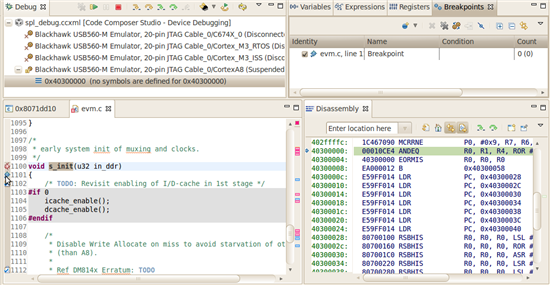

I'd like to debug U-Boot-MIN of DM8148 by CCS. I referred to following web site. I think U-Boot-MIN and SPL are same meaning.
http://processors.wiki.ti.com/index.php/Sitara_Linux_Training:_uboot_linux_debug_with_ccsv5#Perform_SPL_Debug
I invoked steps below and got u-boot.min.sd.
http://processors.wiki.ti.com/index.php/DM814x_AM387x_PSP_U-Boot#U-Boot-MIN_for_SD_boot
The top of Public RAM in DM8148 is 0x402F0400. I loaded u-boot.min.sd to this address and changed Program Counter to same address. Then CCS ran and the terminal was displayed correctly as running U-BOOT-MIN.
But I was not able to do symbol debug because there is not like u-boot-spl file which is the ELF executable. What should I do? Please give me advices.
Kazu

  • Hi Pavel,
    Thanks a lot. I was able to have h/w breakpoint, start_armboot and s_init, on the disassembly window. But I can't look at source file by doing assembly step . And I can't also have h/w breakpoint on the source file. I think maybe this problem is caused by c-compiler option. What do you think?
    Kazu
  • Kazu,

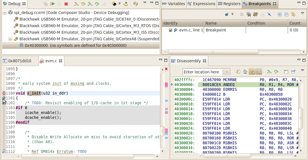

    Yes, this is GCC compiler option issue. I check this with the AM335x team, they compile the SPL u-boot with:
    arm-linux-gnueabihf-gcc  -g  -Os   -ffunction-sections ...
    While in DM814x we compile the 1st stage bootloader with:
    arm-none-linux-gnueabi-gcc  -Os  -fno-common ...
    Thus I add the "-g" flag into the below file:
    u-boot-2010.06-psp04.04.00.01/config.mk
    DBGFLAGS= -g
    OPTFLAGS= -Os
    Now I compile the 1st stage bootloader with:
    arm-none-linux-gnueabi-gcc  -g -Os  -fno-common ...
    The resulted u-boot ELF file is bigger in size than before, now is 336KB, while previously it was 131KB. And now I am able to set a HW breakpoint in the beginning of the s_init function:
    Pavel
  • Hi Pavel,
    It's working now. Thank you very much!
    Kazu
