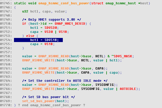

We use dm8148 mmc1, In the kernel "omap_hsmmc.c" ->omap_hsmmc_conf_bus_power()
I find that :
/* Only MMC1 supports 3.0V */
if (host->id == OMAP_MMC1_DEVID) {
hctl = SDVS30;
capa = VS30 | VS18;
} else {
hctl = SDVS18;
capa = VS18;
Also In the datasheet(sprugz8d.pdf):18.4.20 Control Register (MMCHS_HCTL)
It said that "
MMCHS2. This field must be set to 5h.
MMCHS3. This field must be set to 5h.
So does this mean The mmc1 and mmc2 can only use 1.8V supply?
    No I do not think so. Based on the DM814x datasheet, MMC/SD1 and MMC/SD2 can use 1.8V or 3.3V for their I/O pins:
    3.2.16 SD Signals (MMC/SD/SDIO)
    Table 3-28. SD1 Terminal Functions - use DVDD_SD and DVDD
    Table 3-29. SD2 Terminal Functions - use DVDD_GPMC and DVDD
    DVDD_SD, DVDD and DVDD_GPMC can be 1.8V or 3.3V.
    And in TRM, chapter 4 ROM code we have:
    The ROM code supports booting from MMC/SD cards in the following conditions:
    3V VCC power supply, support for 3V or 1.8V I/O voltages
    The ROM Code initializes the memory device or card connected on MMC interface using the standard
    High-Voltage range (3.0V).

  • Thanks for your quick reply。
    So does that mean the code below in the “omap_hsmmc.c”( Kernel) need to changed ?
    I have changed the code to V30 but I still cann't find the mmc1 device, It.What can be "ERRI CTO CCRC" the reason? Here is the log:

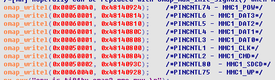

    4.I have refered to the mmc.rtf, I config the pin mux:
