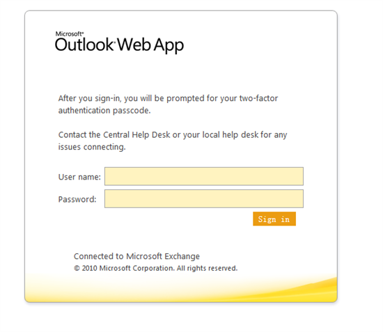

and i  can not open the link(kernel patch):
    All kernel patches are here:
    http://arago-project.org/git/projects/?p=linux-omap3.git;a=shortlog;h=refs/heads/ti81xx-master
    The SATA related patches are:
    http://arago-project.org/git/projects/?p=linux-omap3.git&a=search&h=refs%2Fheads%2Fti81xx-master&st=commit&s=sata
    The patch for the 100MHz clock is:
    http://arago-project.org/git/projects/?p=linux-omap3.git;a=commit;h=135128bdbebb86f7a69554b99de596a22531affb
